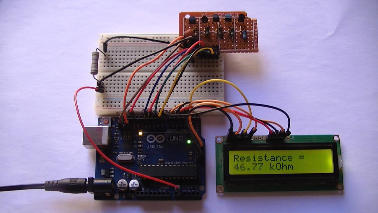

I found for the ohm meter that nice link, also from the same website
