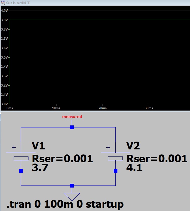

In the attached LTspice sim, i put a 3V7 cell in parallel with a 4V1 cell..........they should become the same voltage because they are in parallel but they dont.
Do you know whats going on.?

This is what mine shows:

In a simulation, nothing blows up when you do something you shouldn't do.
In real life, things are not so forgiving.
Never, never, never, put two mismatched cells in parallel. They should both be charged to the same voltage before you put them together.
Look at the battery current to see why this is not likely a real life circuit.
you didn't set a Rser for V2
