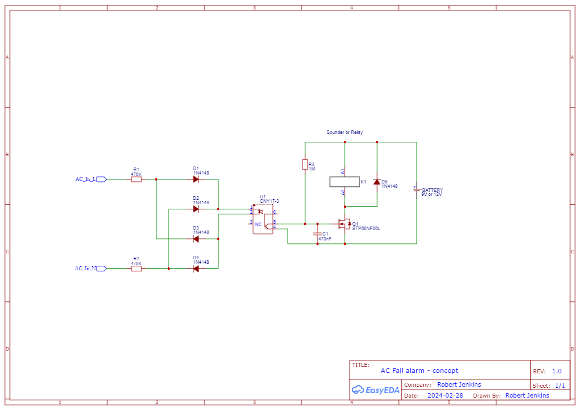

I wish to make a power failure alert on the radial mains circuit that powers our freezer in its own shed. Our old distrution system had a single house-wide trip, so that we'd know if the power was off to the freezer. Our new distribution unit of course has individual trips, so it would be perfectly possible not to notice the freezer shed had tripped out, many hours or worse. I therefore intend to make a noticeable alarm with lamp and probably buzzer alarm, to come on if there was a trip, using a 240v relay. (Lamp and buzzer would represent a very low load on the relay.) I notice that so many relay coils have quite a power usage. As so many household things are already needing necessary standby consumption, a really economical relay seems a good thing to use for something that is on all the time. The most economical relay I could find, at only 50mw is this one from Radio Spares. But they only come in packs of 10. Please would anyone know of how to buy a single one of this type, or something of comparable power usage? Many thanks.

The optocoupler is a low voltage, low current device.
You would need to feed the LED (pins 1 & 2) through a small bridge rectifier, either a module or made up with four 1N4148 diodes.
The input to the bridge rectifier would be fed 240VA through a 1M resistor from live, with the other input to neutral.
The output would control a MOSFET (holding it off) that was switching a low voltage alarm run from a battery. (Or it could trigger a relay to control a 240V alarm, but from battery power).
I'll draw a circuit out when I get chance.
This is a rough of my concept;
The AC is rectified by the diode bridge, with current limiting via the two 470K resistor, so only around 250uA drawn from the mains and fed through the optocoupler LED.
The transistor is turned on for part of each half cycle, when the LED is drawing current, and repeatedly discharged C1, so the MOSFET gate never gets any appreciable voltage on it and the MOSFET is held off.
If the AC fails, the optocoupler transistor does not turn on so the capacitor charges and the MOSFET switches on, over a few seconds. That sounds the alarm or turns on a relay to switch eg. an AC operated alarm.

I suggest Flame-Proof resistors with insulation rated for 500V (1W min) or better, not for power, but length for insulation IEC 60115-1 4.7 and a reverse diode on input of IR opto LED. They will also act as fuses from direct lightning transients limited by power meter at 6kV spark gap.
