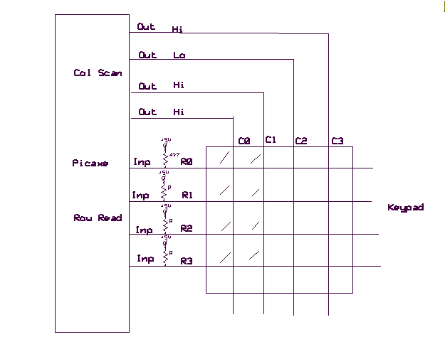

Hey everyone... I am building a keypad lock for a project using a PIC and one of those passive keypa with 8 pins,4 input 4 output. Each of the pins corresponds to a row of numbers on the 4 by 4 keypad, and the 4 output pins correspond to the numbers in that row..so putting a 1 into input pin 1 will make the 4 output pins correspond to 1,4,7,dot. Putting a 1 into input pin 2 now makes 4 output pins correspond to 2,5,8,0 etc... this then goes into the pic and that advances the programme etc.
The problem is, the keypad keeps advancing the program without you pressing a key, the voltage into the pic floats around 1-2.5v which I can't get rid of. I have tried putting it through a 4050 non inverting buffer but then the output of the buffer just floats too... it should be giving out a solid 0v or 5v,not 2.5v
Can anyone suggest what to do?

But on the PIC's I use they have internal 'weak' pull up resistors.
On the pins of the Picaxe that are used as inputs from the keypad, you need to have on each of the 4 pins a resistor from the pin to the +5V supply. The value of the resistors can be from approx 3.3K thru 10K, these will stop the pins from 'floating'.
If the output pins of the Picaxe to keypad are 'selected' high, you may have to connect the resistors as pulldown.

The way I read your post, is that each column is pulled High in turn while the other Cols are low, and the Row pins tested for a high. [ if key pressed]
So that means you need pull down resistors on the Row inputs, say 2K2 or 4k7 resistor on each Row input pin to 0V.
So when no key pressed all Row pins are low.
A key press on a Col thats high will put a high on the correct Row pin.

EDIT: do you mean this sort of setup? (red arrows just included to help clarity)
Note the significantly less amount of effort put into this diagram for no reason at all

Without pullup or pulldown resistors on Inputs that can be left 'unconnected' to an external source, the inputs are 'floating'.
This means the inputs can assume any state ie : '0' or '1'.
By placing your hand or objects, wiring etc, close to the pins, there can be sufficient induced voltage, to make the high impedance [CMOS]
inputs at a an indeterminate state.
So when your program reads the input pins it could be either '0' or '1'.
By connecting pulldown resistors the unconnected input pin will be held close to 0v, so the program will 'see' a '0' state.
For a Column that has been set to 5V by the program, will, if a key on that Column is closed, then Row pin will be pulled to +5V, which the program detects as a '1'.
Note: In some cases depending upon the sense the Column is set active, it could be that the unselected Cols are all high and the selected Col is pulled low.
In that case the Rows would have pullup resistors, so when a key is pressed the Row pin is pulled Low.

I think I understand it now, the pull ups worked by the way, the outputs now sit nicely at 0 or 5v, not in between
Thanks very much for helping me so quickly :)
