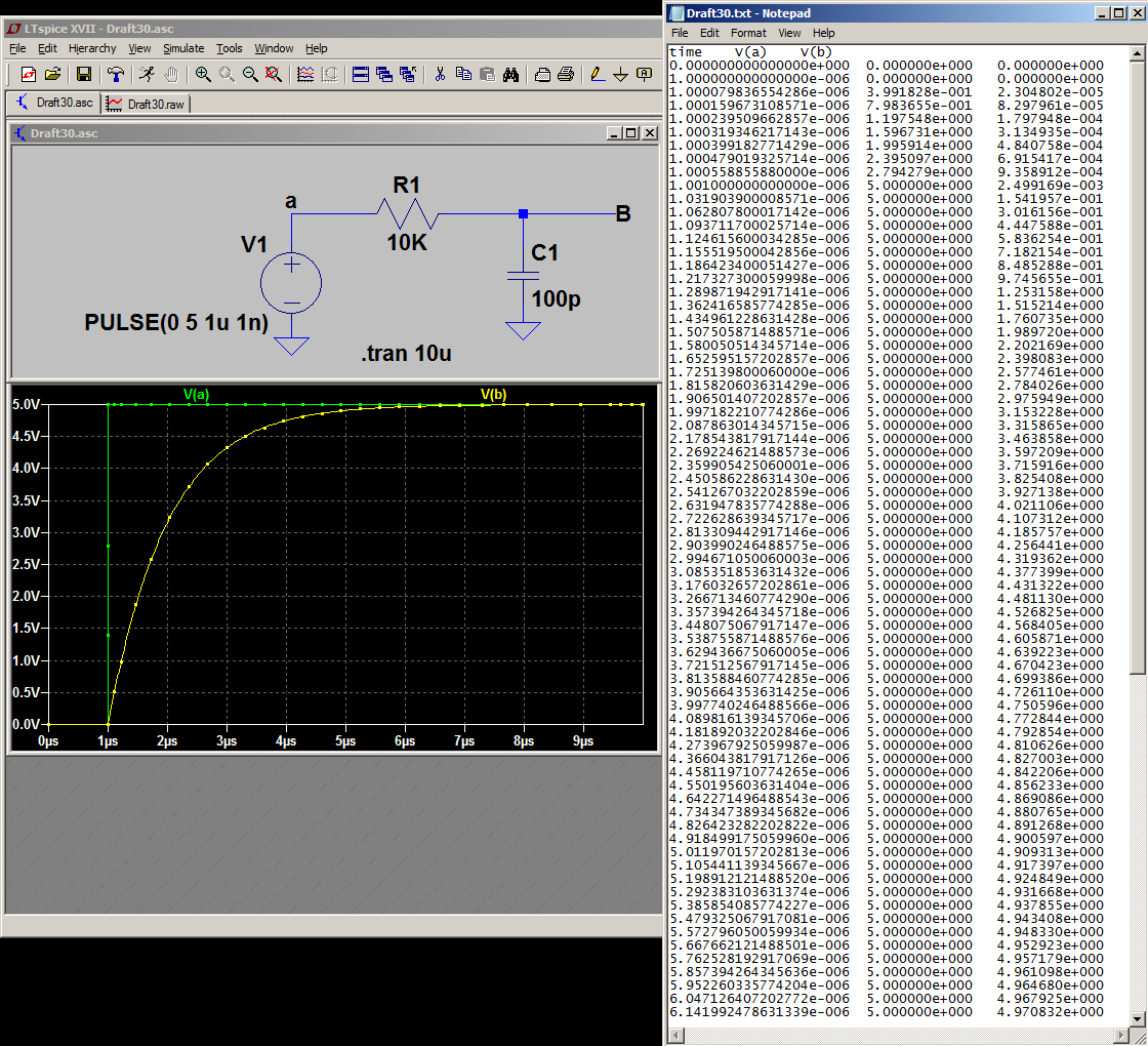

Are you trying to import the Spice circuit description, or the results of a Spice simulation (voltages at nodes vs time). I suspect Matlab could understand the latter, but wouldn't have a clue as what to do with the former...
Here is how to do it in LTSpice.
I created a trivial circuit and simulated it.
I plotted the voltage vs time at node a V(a) and node b V(b).
I asked LTSpice to export V(a) and V(b) vs time into a text file.
I show the contents of the text file.
I'll bet that MatLab could deal with the contents of the text file (I'm not a Matlab user).
