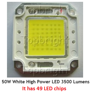

Here is a photo of a 50W LED that has 49 LED chips inside. Its forward voltage is 23V so it has seven parallel strings of seven 3.3V white LED chips in series.
