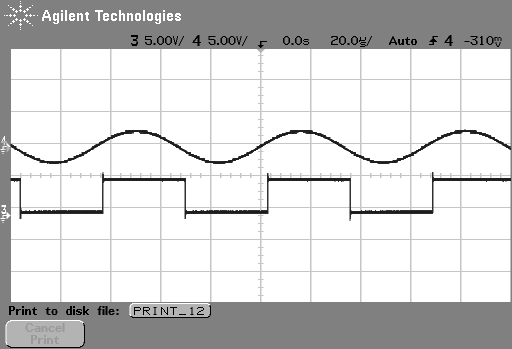

I have a source TTL which is derived from a sine wave (16KHz) at 0° phase. Using this TTL signal I am deriving a PLL. I would like to be able to add delay to this PLL so that I can adjust the rising edge of PLL output from 0° phase and +90° phase of sine wave (about 1/4 of its time period) from which its derived.

If we forget about PLL, how can I delay the TTL signal with user adjustable control between 0° phase and +90° phase of sine wave?

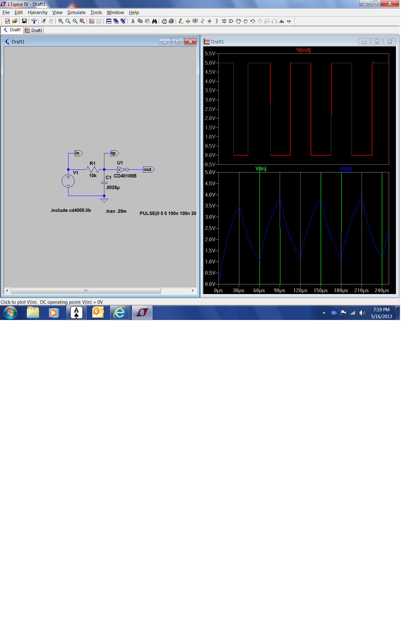

Since the wave period is ~60us you could use a simple R/C circuit and another gate to provide a delay up to ~15us.
I am trying to implement the delay using an op-amp and following the method in this article. Can someone try it in a simulation and let me know the R and C values that works best for a 16KHz sine wave with a delay adjustment of 0s to 15μs?
I tried using 10K pot with 0.001μF and it doesn't look good as the bottom of sine wave is flattening.
thanks

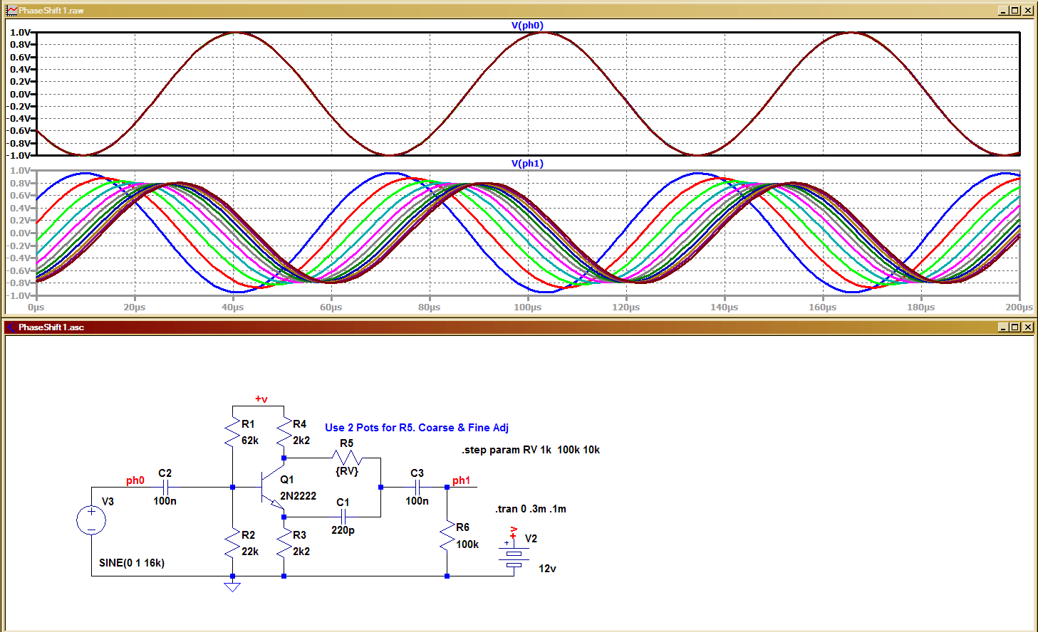

If you have access to the original sine wave you could use this simple phase shifter.
Use a variable pot to adjust the phase shift and select the correct phase to create the square wave.

Thanks for your schematic Eric. I will try it right now.
E.
Tried this and its working fine. The only think that I changed is to use 15V rather than 12V as I can see some distortion in the rising edge of the output at 12V. This can be used into my design, but I have access only to 5V on my digital board, are there any other variations of this using 5V or should it have to be above 12V?
