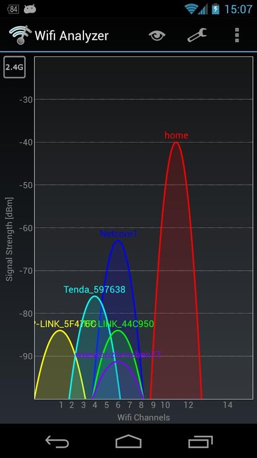

I see that you too are a man of culture. I use Wifi Analyzer too to nudge my signal right in between every other signal. I have to go to greater effort to squeeze it in than you did.
Fooled you.
That picture is from Wifi web sight.
I do not live in town. There are no neighbored to cause trouble.
I have 1="Simpson-North" that connects the house to the barn and green houses. Includes channel 40 a 5190mhz.
6="Simpson" Which is for the house.
11="Simpson-South" that connects over to the Kid's house. And channel 161 at 5815mhz.
Then on 5ghz (#149). I have a repeater that jumps 5 miles to the grain elevator (tall building). From there it connects to fiber.
I want to add some wifi cameras in the middle of all this. I probably need to clear up one channel just for cameras.

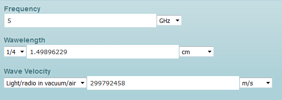

Can you please explain a little more that "a 1/4 length aerial" ?What should be the aerial length ?How can I calculate?

First, determine the frequency of the signal you wish to monitor (for example, 5GHz).
Then, using this calculator (or similar), determine the wavelength:
1. enter the frequency (for example, 5) and select the multiplier (GHz)
2. Select the Wavelength (1/4) and finally,
3. the measurement system you prefer. For this example, you should see this:
A single strand of solid copper, of the indicated length (in this case, round to 1.5cm), will suffice as a 1/4ω aerial for most tests. Accurate power tests will take some finessing of aerial's orientation with the source.
How you connect the aerial to your RF power monitoring device will be for you to determine.
