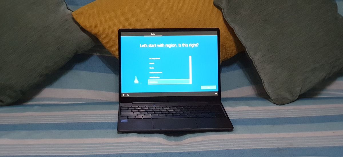

I got hold of a mini laptop in bad shape. I fixed everything except wifi. The situation is that right now i simply have 2 cut wires connected to wifi card, one is 4G and one is 5G wire. The laptop case is metal all around. I connected the 5G wire to some spare laptop mini antena and got 100Mbps when it was outside the case. As soon as i glued it to the case, went down to 8Mbps. I figured the only solution is to glue a mini antena to the outer side of the case, i got just enough space at the rear end of the laptop. In order for both antenas to fit, each would have to be no more than 1cm x 3cm (0.4 - 1.2 inch).
Since i never dealt with antenas of any kind before, what would be the best option to do this ? Should i order premade antenas or can i just make 1 from materials i have at home ?
I added some pictures. You can just spot where i put existing antenas, green on the bottom right (4G) and 5G on the left, sadly there is an LCD cable over it and screen case is metal, so blocking from all sides. Now i wanna put a new antenas in the middle. The default situation was both antenas were in this place at the bottom of the screen where you see the plastic is broken off. Its a chuwi laptop so i couldnt even find picture of the original antenas, let alone option to order them. All i know from pictures of built laptop that antenas leave the laptop case and go into this spot at the bottom of lcd.
