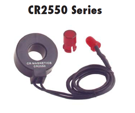

For a totally non intrusive solution:
All in one with the LED already connected. Just run one of the line wires through the doughnut hole. Virtually no soldering or connecting required and no external power required.
Ron
Only $12 at Digikey. You still have to shut power off, get inside the pump controller box, unhook a wire from the contactor, thread it through the hole, and it costs 12/0.25 = 40X what my cell-phone charger did ;)
Upon further deep thought and investigation buy a cell phone charger. :)
But I do love those little things for industrial applications.
