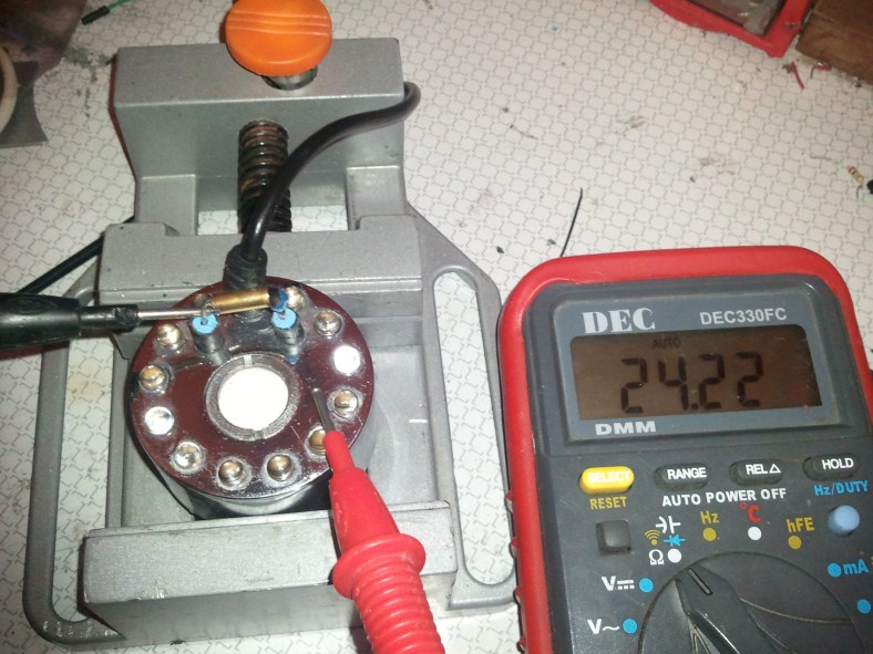

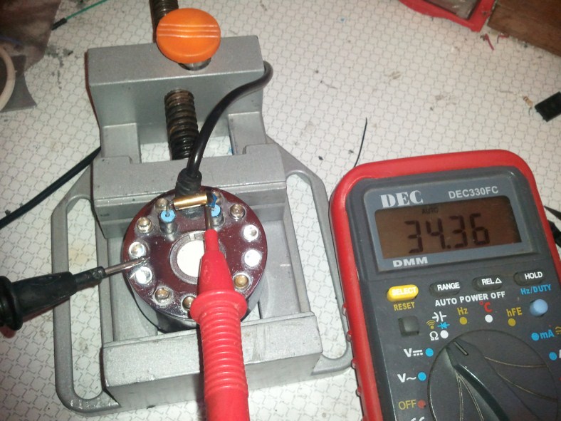

But as you can see in these pictures there is resistor between sensor and case!
There's no apparent reason why resistance shouldn't be present. If I were trying to measure a change in capacitance (assuming the sensor is a capacitive type) one option would be to use an RC-oscillator and sense a frequency shift.
