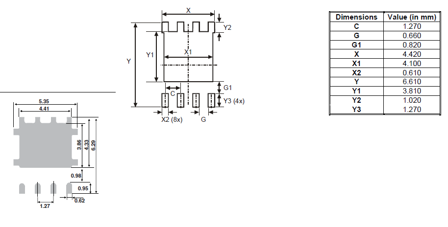

unfortunately, POWERDI5060 is one only at diodes.com
I see that the FLAT 5X6 , FLAT 6X5 and the DFN6 are the same foot print. Or close enough to work.
Look at the FLAT 4X6 and the POWERDI5060. Pin to pin spacing is the same. I won't do the work for you but test to see if the 5x6 will fit on you 5060. You might have to scrape off some solder mask. For a couple boards I would just use extra solder.
If you did not think ahead enough to make a foot print that will except both of these patterns then you have a problem. Next time....... You need to have a alternate part for each item. (OK not the PWM) If you don't have several alternates then you will have trouble real soon. (part shortage)
thanks, I checked but small, strange protrusions have been added to other footprints which ensure that our powerdi5060 footprint fits absolutely no other footprint.
Then again, why would they want our powerdi5060 footprint to be able to take other companies diodes , -it just results in lost business.
I agree ive made a big mistake here, I only used this footprint because the pcb is tiny and I had little space...the powerdi5060 was one of the few that fitted in the tight space.
I should have searched for a footprinted diode which can fit multiple company's diodes....does anybody know one?
I wanted a DPAK,, because thats standard , but DPAK is just too big for the space I have.

these 4 prototype boards cost us £1200, with a lead time of 2 weeks.....we may have to throw them away, but I would rather not, I cant see how we can be sure of not falling into this trap again and again....how are we to know when any component is going to go nil-stocked?
None of these "legless" style footprints fit each others footprint, so when one goes nil-stock, we are dead.
As discussed, DPAK would be nice, but we don't have the room.
