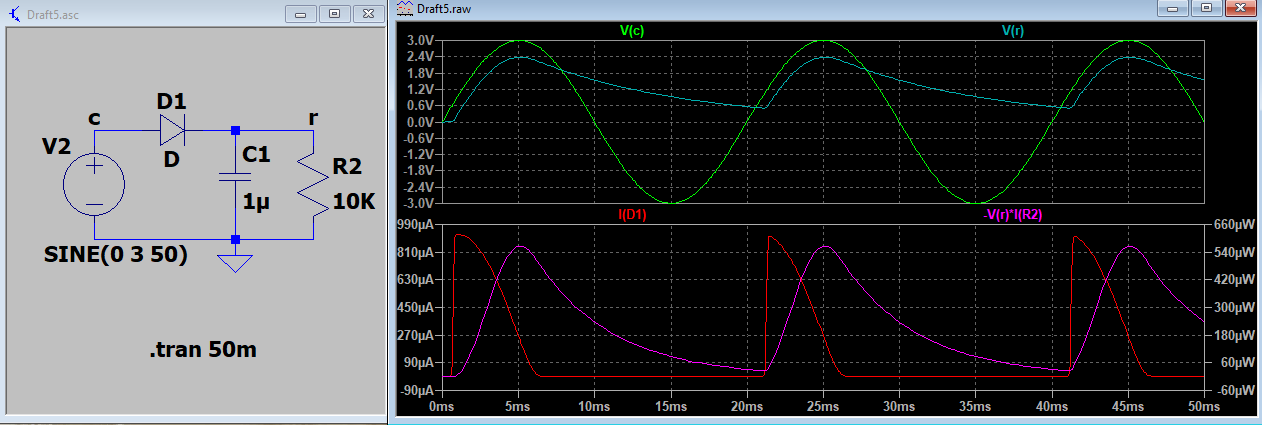

hi guys. i have aquestion i want to know how can i measure ripple voltage in this circuit (attach) in pspice application. and how i can find maximum current diode domain in pspice please help me. thanks

It is trivial to do, but you have to make some assumptions:
What is the A.C. voltage source peak-to-peak voltage?
What is its frequency?
What is its internal source resistance? (or is it "ideal")?
What are the attributes of the diode? (or is it "ideal"?
Here it is with a 3vpp 50Hz ideal source with an ideal Silicon diode.
Notice that the first current pulse is subtly different the subsequent ones... Notice that LTSpice is smart enough to plot the power in any component, in this case, the 10k resistor.

thanks my friend for answering. i want to know how i can measure ripple voltage in pspice. idont know how i can in option of pspice?
As you can see from Mikes post he used the transient function, you can set this in the 'simulation' menu, or if you dont set anything it appears when you click run.

Spice is Spice is Spice.... They are all derived from the same algorithms...
Measuring the ripple is not an "option", it's just a measurement you can do as part of a transient analysis of any Spice program.
If you don't know how to do a transient simulation in pspice then you need to learn that first.
Is this what you meant, I just used ltspice, I drew your circuit and used the oscilloscope function to look at the ripple.
I used the sine function for the voltage source, at 50 cycles.
