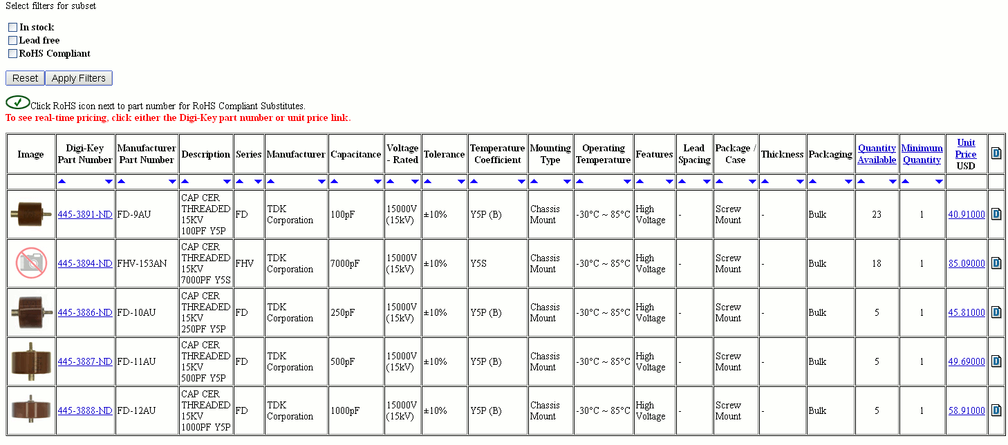

i need about a dozen or so 15 kV capicitors at various µF ratings. where can i find these?
ive checked digikey
Well you've not looked very had then:
EDIT: Digikey doesn't do linking to search results, here'#s a screen shot.
Well that link doesn't work, but I doubt you'll find uF values at 15KV generally available (and pretty big if you can), it's usually only pF values that high a voltage.

Does it matter? - you don't really get uF values at 15KV - and assuming it's yet another post on the same subject as his others, he's only looking for 1000pF 15KV anyway - which Hero999's post above shows.
