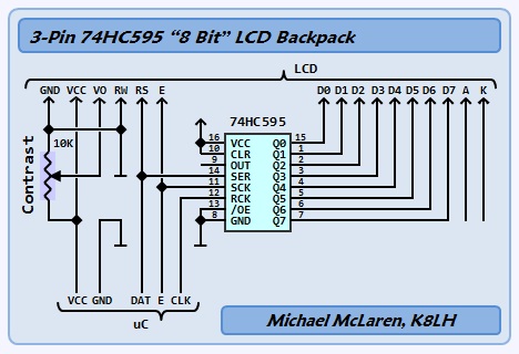

...I built a prototype this morning and it came up first try (I love it when that happens). Anyway, here is picture proof that the K8LH 3-Pin 74HC595 LCD 8-Bit Interface Mode Backpack is a "working" design.
It should work, running a separate LCD E line from the micro and 2 micro pins to drive the shift register has been a standard way for a long time. Mainly people use that system for 4bit versions but it has been done plenty of times for 8bit versions too;
Thanks for the link, Roman. It was very productive. While the author hints that there is a 3-wire 8-bit mode interface, I couldn't find any, other than my old 74HC164 interface, so I asked him about it and he came up with a real gem.
The interface from the Arduino guy is very nice. After re-wiring my prototype backpack and modifying the driver to eliminate the extra clock pulse, it fired right up. I've attached the circuit drawing and modified driver below.

3-pin-74hc595-lcd-8-bit-mode-backpack-jpg.70079

Is there anyone who can post the complete code and Schematic?
I'm just beginning to learn c and wanted to study it. (So, any and all comments in the "Code" to help me would be great!) I'd like to build this someday too!
Thanks, kv:)
Good job!
It's in asm But Mike has the comments on a sample that is C style really neat in sowing the logic to the code.
The SCH is in post 46

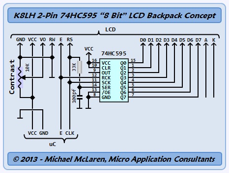

Caveat, Burt. There are actually two versions of 3-pin 8-bit lcd interface schematics now. The one in post #46 is the one from the Arduino chaps. If that isn't confusing enough, I'm just getting ready to wire up and test this 2-pin circuit;

Hey guys, the new 2-Pin 8-Bit design also came up "first try"... Here's a picture of it moments after firing it up for the first time;
k8lh-2-pin-74hc595-8-bit-mode-concept-jpg.69955
I'm geeked about this design. Like the K8LH 3-Pin 8-Bit design, only one byte is written to the 74HC595 for each byte going to the LCD. The driver is isochronous and reasonably fast (about 100 microseconds to send each byte to the LCD).
   *  K8LH 2-Pin 8-Bit 74HC595 LCD low level driver (isochronous)   *

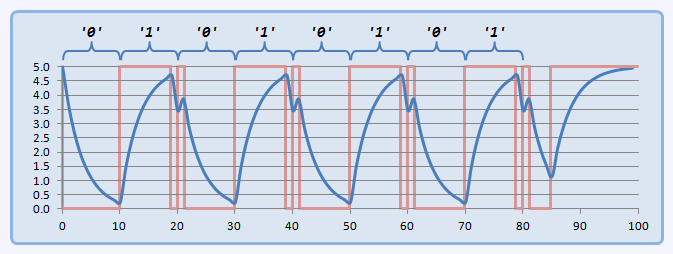

The RC time constant (τ) is 3.3 microseconds and the driver uses a 10 microsecond (3τ) interval to charge or drain the capacitor on the 74HC595 SER pin just before clocking each bit into the shift register. Here's a diagram showing the RC integrator input (pink line = SCK pin) and output (blue line = SER pin) when using a 4 MHz clock;
rc-timing-png.70091
I have C and assembly language demo programs (18F14K22) for this 2-pin backpack design, if anyone is interested.
