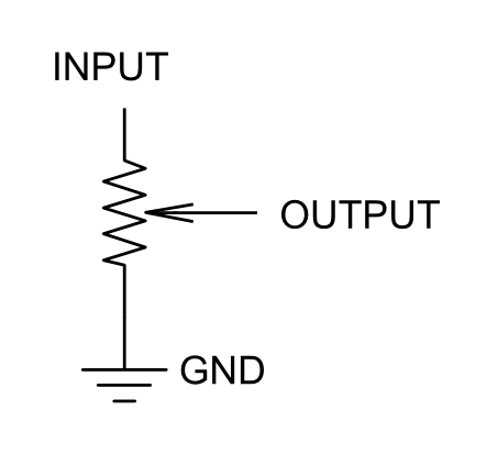

Just found a perfect illustration on google:
fetch
For clarity, when I mention the top or bottom of the pot, it's relating to how a volume control is commonly drawn in a schematic diagram, like this; top end input (clockwise terminal), wiper output (middle terminal) and bottom end (anticlockwise terminal) grounded.
That also shows how it can be considered two resistors, if it's not at one extreme end; the parts of the resistance track above and below the wiper.
The fixed resistor mod in effect removes the part below the wiper and replaces the part above it with a 4k7 fixed resistor, in each channel.
