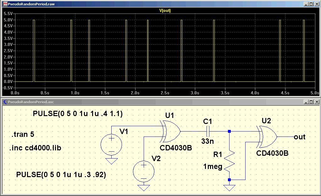

I've been tinkering with LTspice's rand(), random() and white() functions without success, trying to model a pulse generator for fixed-width pulses at random (or pseudo-random) intervals. In the end I gave up and just used the circuit below. Anyone know of a simpler model ?
  • PseudoRandomPeriod.asc
  • Like
Reactions: jjw

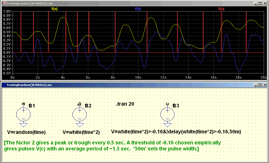

A bit more tinkering and I think I've sussed those Spice functions. In case anyone's interested, here's my solution:
  • TestingRandom()&White().asc
I am not familiar at all with those functions, Alec. In fact I did not know they were there.
Is it the equivalent to randomly varying frequency and also duty cycle, right?
I do not intend to derail your thread. My question: what would be the expresion governing duty cycle? Random as well? Thinking of this if I had to implement this with a micro.
Hi Agustin. Yes, since pulse width is fixed and period is random the duty cycle will also be random.
