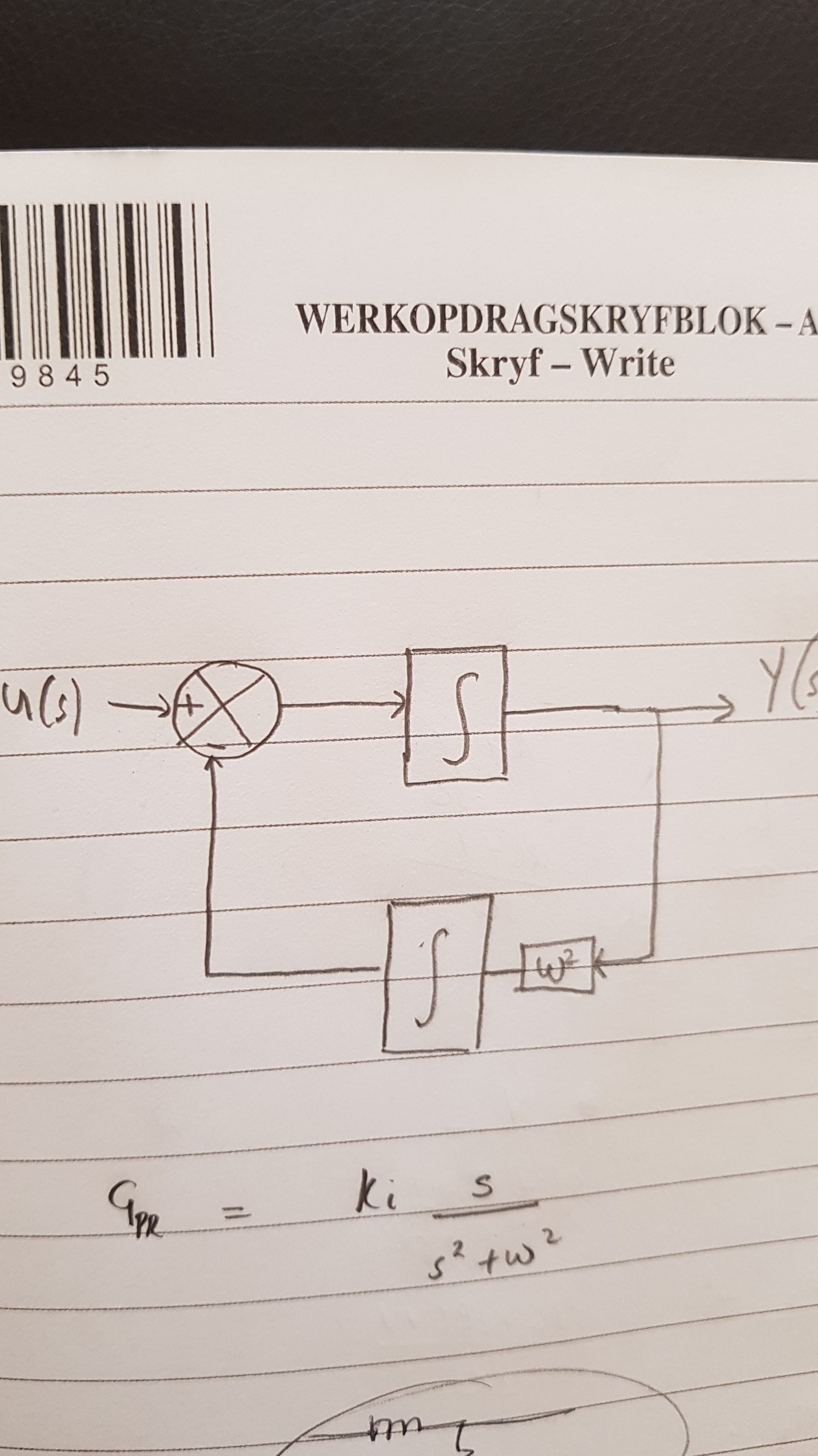

Generalised integrator OP AMP
Ande Mandoyi
I am attempting to design a GI circuit for a PR control block (see block diagram attached). The math and simulink model check out but I'm having a little trouble converting the transfer function and and block diagram into an actual op amp cirvuit.
