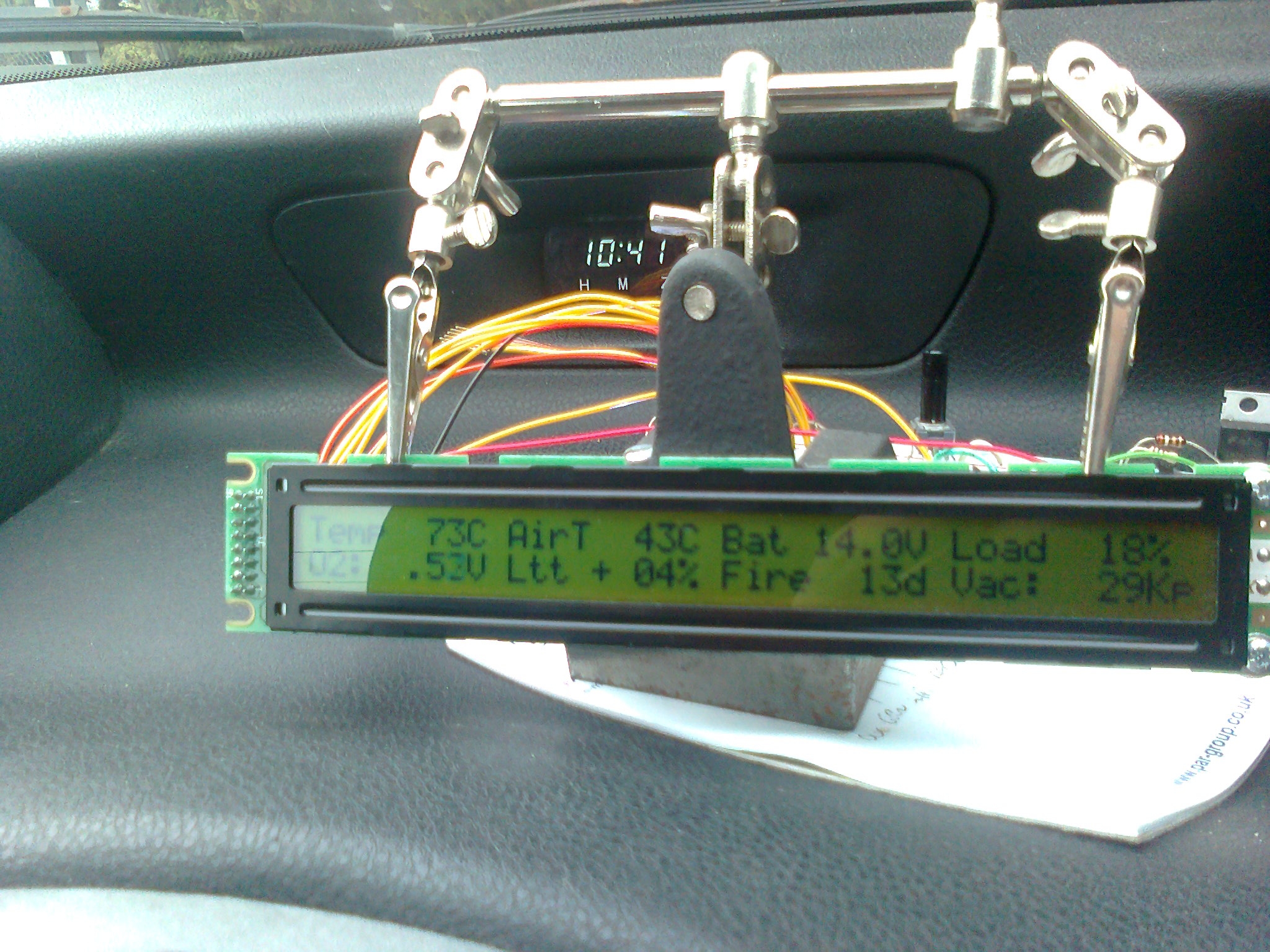

I want to communicate to a vehicle ecu with a pic via rs232.
Using a ELM327 protocol converter ic designed for the job this is a simple task, to get basic data anyway.
You used to be able to get a cable that contained a obd diagnostics connector, a elm327 chip and a d9 on the other end, but nowadays you can only get them with a ft232 rs232 to usb converter chip as well and a usb connector, due to the fact most slaptops dont have a serial port.
I was wondering on the feasibility of hacking my usb to obd interface and bringing out the rx,tx,dtr and cts lines from the ft232 (I know its an ft232 inside the interface as windows 7 tells me it is).
I have a pic programmer that is rs232 or usb, there are links you position for rs232 or usb, I suspect the links just connect the tx and rx from the ft232 chip (it has one too) to the rs232 connections on the on board pic controlling everything.
Its ok I sussed it.
I cut through the tx pin on the ft232 and bent it up, as its low impedance and would mess up comms, I left the rx pin on the ft232 as is and everything else for that matter.
I then connected the rx and tx pins of the elm327 (actually a pic) directly with a couple of bits of wire to my usb to rs423 converter (rs232 but 0 and 5v instead of + and - 12V), and it works.
If I now connect a pic to this I'll be able to communicate with the vehicles ecu with a pic using a uart.
I'll still be able to use the obd interface as obd to rs423, or I could resolder the tx pin on the ft232 to put it back as was, which is unlikely as the interface will now become a part of this project.

My device now displays 8 parameters on an lcd, I'm just having to suss out long term and short term fuel trim protocol, some weird scaled 2's complement thingy.
Well heres the prototype:
Theres an led round the back to indicate open or closed fuel loop.
The ecu in my car must be kinda busy as it takes around a second to update the whole display.

Interestingly I found and rectified a couple of minor faults on my car since I got this to work, the short and long term fuel trim are kinda usefull for that, esp when you do things like disconnect an injector one at a time and see what effect it has on the trims, you can test the injectors within a % this way.
