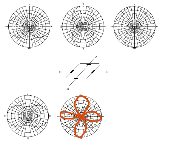

If only two elements were working and you stood above the antenna looking down you would get a pattern like the left one. (AB)
If the other two elements were working then the middle picture would be correct. (CD)
If all four elements were working then the two patters will add and you should get the pattern on the right. (ABCD)
The book says; If you look at the radiation from the side of the antenna, where 0=up, 90=N, 180=down, 270=south, the pattern is on the bottom left. I think it is what I make on the bottom right. Now I need to defend my position. If element A and B are driven in phase and are 1 wave length apart, then the energy from A will reach B and add (2X). At about 45 degrees the energy from A will meat the energy from B at 1.5 (x.5) wave lengths off and subtract (o). At 0 degrees, and 180 the energy from A and B will add (2X). I can not think about this more I need to leave for work in 8 hours.
I do worry that your antenna is not 50 ohms. I need to get out my ARRL hand book and see if I can find an example. Two dipoles 1 apart, driven in phase what is the impedance? What is the pattern?

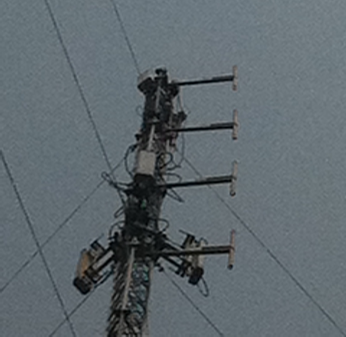

Hello guys. I finally got a response from the guy who sold me the antenna. He said the way I did it is wrong. They should be mounted all vertically above each other with a separation of 260cm (Just like some of you pointed out). Like this photo here:
Also look at the pdf I attached.

Why is it any different?, in either case you have a horizontal beam which needs connecting to the vertical mast.
Forget it Nigel. It is not something to worry about really. If necessary, we will just wield them somehow into place.
My concern is why you have a problem, as I see it the aerial is a vertical dipole, mounted on a horizontal beam.
Mounting it incorrectly horizontally (as you did) is surely just a matter of rotating the vertical dipole 90 degrees, with the beam staying horizontal.
I am back for 10 minutes. Now that you will build the antenna vertically it will be tall. You should not have metal wires going through your antenna. Below the bottom element metal wires are OK. (10 feet below) I have fiberglass rods with eye holes on each end. From ground to a point below the bottom element is wire, then I change to fiberglass so the RF is not in the wire support. The top of the support wires needs to be non conductive. Because your pole is not strong you need many wires. Rope stretches too much. My antenna say how much pressure a 100mile/hour wind pushes per element. With some math you can see how strong the supports must be.

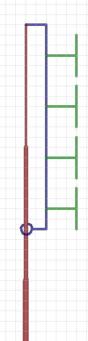

The wires are not conductive. One problem I'll face now though is that our mast consists of several pieces (Telescopic mast). The final piece will not be enough to mount the four antennas with the required spacing. So, we will need to mount two antennas on the final piece and the other two on the piece before that. That will make spacing them too difficult.
You know, if we bring down the mast, the last piece will have to go down and get inside the previous one. The only other way is to use a crane to left somebody who can do the mounting. Tough.

Green is antenna.
Red is telescoping pole.
Blue is new pole that attached to top of telescoping pole and the bottom slides up pole.
I hope this idea helps.

Yeeees, I was exactly thinking about the same idea. I was even planning to draw it, post it here and send it to my technician. Now, I'll just send them your drawing ^_^
