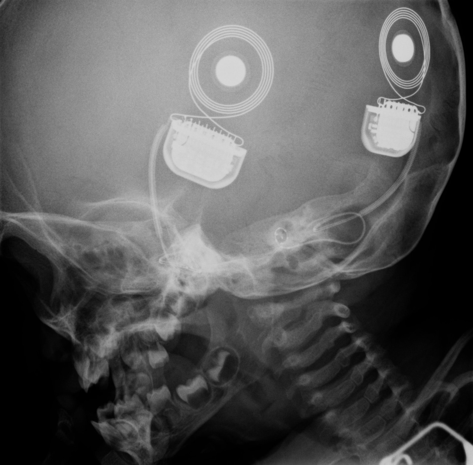

Any kind of electronic implant MUST have a battery built in to be able to operate on its own. With no battery, it is only powered when the external unit is located over it's coupling coil.
They do not use radio communications as that takes [relatively] massive amounts of power and the battery life would be reduced to days or even hours.
Any communications - and often power or battery charging - is done via a coupling coil placed over the device, working in conjunction with a coil in the device or linked to it, just under the skin.
If you look at x-rays showing people with cochlear implants, you can easily see the coupling coils that allow them to link to the external unit. That's state-of-the-art implant technology.
The external power or communications unit could have bluetooth or wifi etc., to pass data from the implant - I think?? some cardiac pacemaker systems work like that, so a doctor can do remote checkups with the users cooperation?
Note that all the stuff online about supposed injectable or implantable "tracking" or "controlling" implants is total fantasy, they are absolutely impossible by basic science and physics, for multiple reasons.
The nearest thing in reality is an RFID style device like a "Pet passport" tag, by no means invisible or undetectable and only working when a reader device is within a few inches to power it. They are the same basic technology as contactless keyfobs or cards for door entry systems etc.
An example of how cochlear implants show up in an x-ray - the connecting coils are clearly visible, the circles in the centre are small magnets that hold the external part in place on the skin. The box is the electronics unit and you can just see one of the small spiral electrodes in the ear, if you follow the wires down.
