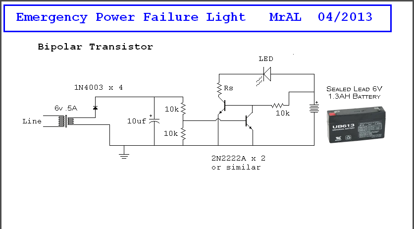

Okay, I am working on an emergency LED lighting that will run off a 6v battery when the lights go out. I attached what I have now. I have the battery ordered and on the way but I am not finding the right charger. I found that I will need a "Float Charger" to make sure the battery is not over charged as it will stay connected all the time. And MrAl was kind enough to provide schematics on how to create and electric cut off switch.
Issue is, the cut off switch is being ran from a DC source. So I THINK i have to connect the +/- from the Float charger to the line in on the schematic. So when power is on the float charger is providing power to the battery and the LED's are not on. But from what I have gathered by testing my camera charger is that the float charger will start to pulse on and off when its full, basically testing the charge and turning off over and over. This means the emergency switch will activate and deactivate over and over and turning the LEDs on and off.
I haven't tested this because I don't have a charger yet (Well, I do but I have a 12v float charger and getting a 6v battery. So i screwed my self when i ordered the wrong voltage...uhg(its a 12v 500mA)) but when I get one I think this is what will happen. I cant hook the schematics power source behind the float charger circuit because then it will over charge the battery.
All I want to do is have an AC line go to a transformer (float charger) to keep the battery charged but use the same power source to control the switch and activate the LED's. :confused::confused::confused::confused:
Any ideas?

Are you saying you ordered a 6v float charger or you want to build your own using the same transformer as in that schematic?
If you order a 6v float charger and it is isolated from the line you can connect that to the battery and that should work ok. But you'll have to make sure it is isolated. It probably is though.
If you want to build your own then we can find or design something. The simplest designs use the LM317 linear regulator. The main points of the charger are full charge voltage set point and current limit, and float voltage set point. If you design your own you can go back to a full wave bridge rectifier unless you still have other stuff common to one transformer lead.
I ordered a 12v float charger so I need to order a new 6v one to match battery. But my question was on the design you made MrAl, if I use the float charger as my DC source to activate the LED's and to charge the battery, will it pulse on and off? because the float chargers pulse when the battery is full. I cant hook up a constant line to the schematic above because i think that it will give constant current to the battery and over charger it. Only Idea I had for that was to throw is a diode to make it only push one way out from batter and just hook up the charger on separate circuit.

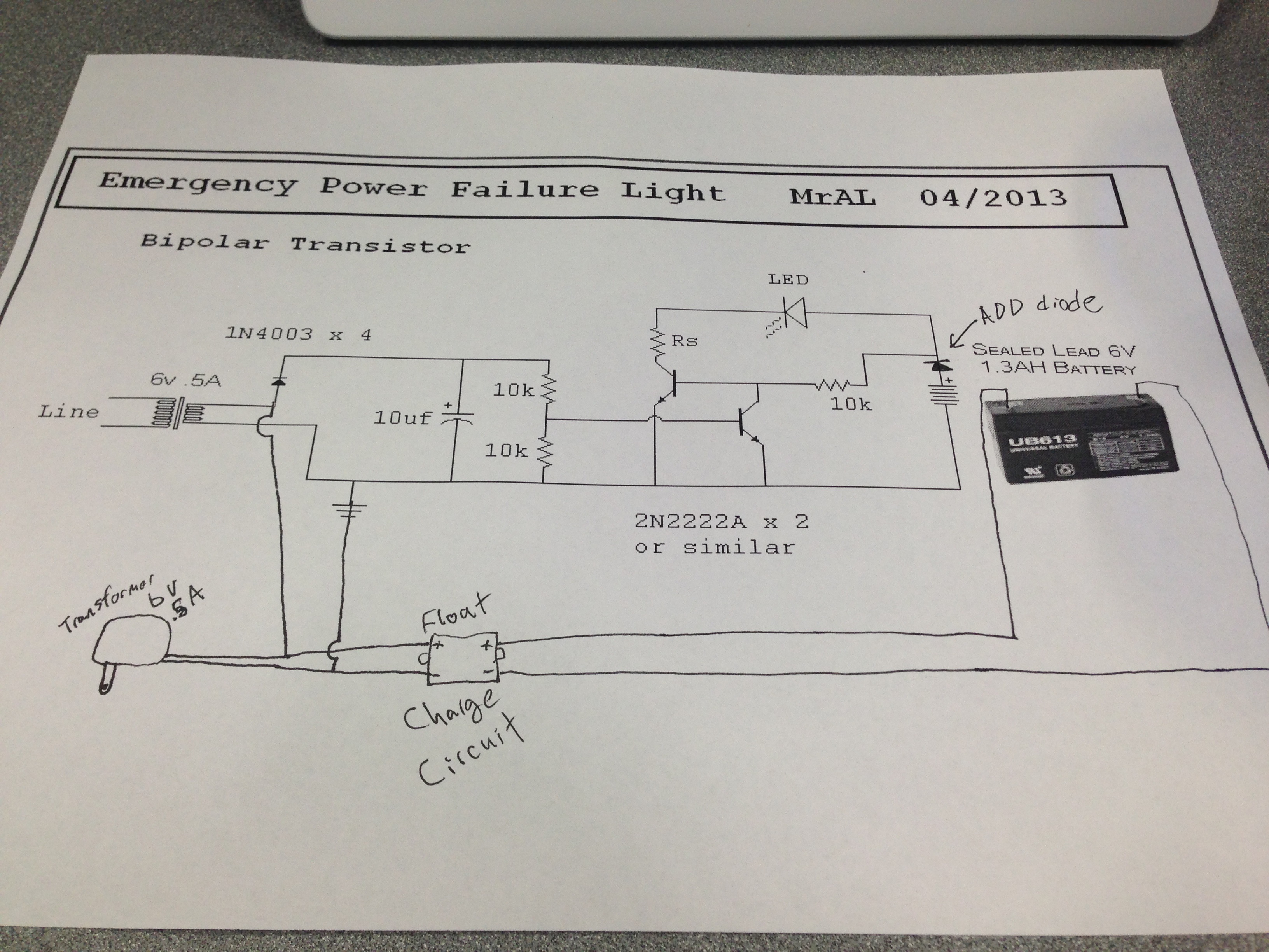

Okay, so i was thinking then i can add a diode that will force voltage 1 way away from battery and then hook up tge charger seperate
Yeah it's tricky because if the float charger has to connect directly to the battery (and it does to sense voltage correctly in most cases) then you cant also use if for sensing. A diode probably wont help either because we cant use a diode between the battery and float charger.
However, a very small wall wart would work well enough to use as the transformer in that circuit. Any voltage around 5v or more would work.
I mean if i can tap into the battery charger DC out befor it hits the float charger i can connect the constant voltage to the schematic above to power the on off circuit. Then on the right side of the circuit that connects to the battery, force a one way flow from the battery to the LEDs and then hook the float charger to the battery directly so it can charge. Think will work that way?
Oh i didnt realize you had access to the low voltage DC side of the float charger. There may be a way to do this and that might work.
However, you can not make the connection between the input (-) side and ground of the circuit unless the float charger has a common ground.
So the question is, does the charger have a common ground?

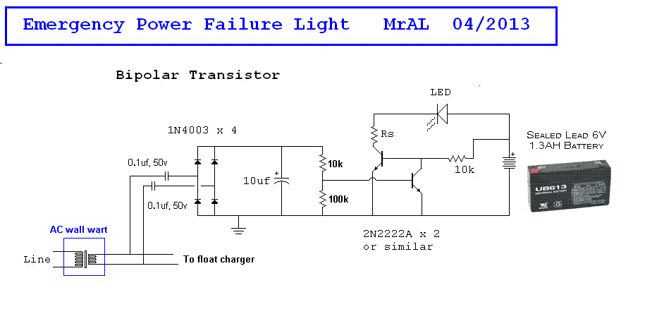

You should be able to use that anyway. Probably with a capacitor and full wave rectifier. The cap will isolate the wall wart from the circuit for DC, but allow AC to activate the sense input. You'll need to use a non polarized cap maybe 0.1uf and then lower the value of the filter cap in the detector circuit to 0.1uf also. We'll have to see if this works ok.
Here's a method that should work regardless which lead the wall wart is common with on the output...
In place of the transformer in that previous schematic, use two capacitor 0.1uf each. They go from the AC wall wart output to a full wave bridge rectifier. The output of the rectifier goes in place of the transformer secondary.
So what we are doing here is detecting the AC by coupling the AC to the bridge, then use the bridge output as the DC detector source to drive the transistor. A 10uf cap should be ok for the filtering.
Yes that's not a problem. The main problem was keeping the output leads from the wall wart from connecting directly to the ground (negative side of battery) because that could screw up the charging circuit. But we still had to make it common to the detector circuit (diodes, transistors) so that it could drive the base of that one transistor. Notice that the max voltage that could get through would be 0.7v because the base emitter keeps the incoming voltage at that low level. Even if something went wrong with the transistor circuit the two 0.1uf caps would hardly provide any charge current...a truly insignificant level.
Take a few measurements after you get it hooked up and make sure the battery charges properly and everything works as planned.
