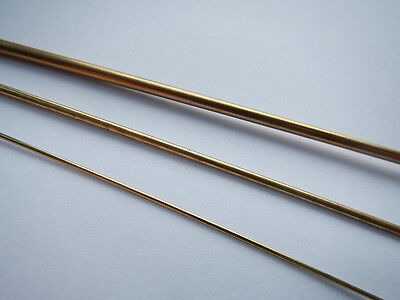

The original connections are most likely just steel wire or piano wire, which is not all that good as it corrodes.
You can easily get 1mm brass rod on ebay - eg:
Anneal it at the points it will be bent, to avoid it cracking.
You can also get tiny square or rectangular sections, phosphor bronze (springy) strip etc.
@rjenkinsgb - your spot on ;-) - this light uses 0.5mm steel wire as its battery connections and piano wire matches. I'll use my miniature butane blow torch for heating and bending in my small vice.
