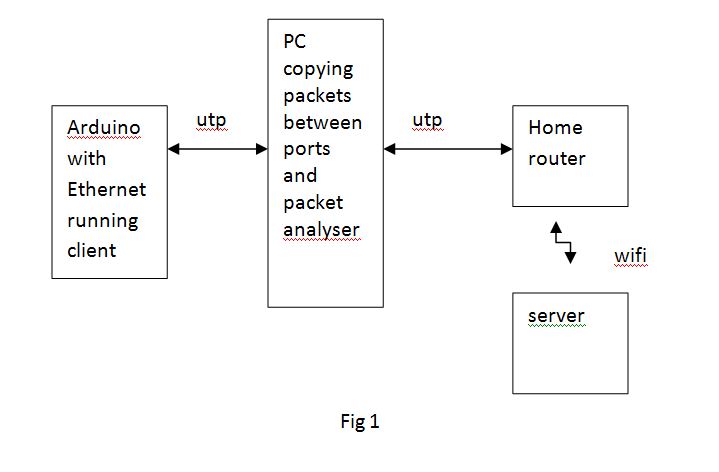

I definitively agree about the disadvantage of a tap. Unfortunately i don't have a switch per se I do have dsl/cable routers which could be used as switchs with dhcp disabled but they do not offer port mirring. I think i could manage to have 2 ethernet port on a PC, Is it reasonable to think of a program which will forward between the ports and having wireshark capturing the data from/to one of the port?
I believe if you have two NICs in a Windows PC you can configure them to bridge between networks. Never done it but I'm sure if you Google 'windows bridge' you'll be able to find out more. If you can bridge the traffic then monitoring one NIC with Wireshark you'll see the traffic passing between LAN segments.
