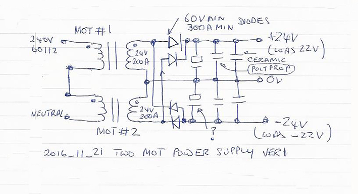

That is a pretty neat schematic Garry.:cool: I suggest dropping the supply lines to 12V, as previously mentioned though. UPDATE 2016_11_22: Also the supply lines need to be regulated.

I am thinking 40,000. uf on the +22 vdc side and 40,000.uf on the -22 vdc side. 30,000. uf on each 15 vdc.
I have several MOT transformers I can use but the primary coil is usually 100 turns on all of those that is 1/2 was is needed for 100% duty cycle. I have some good transformers I can destroy for the EI core then rewind it with the correct primary for 100% duty cycle this EI core is larger for correct primary winding for 100% duty cycle but not sure I really need 100%. I have a 2500 watt EI core I saved from a cooked transformer it will need to be wired 240 vac on the primary. I still have not decided which EI core to use yet. I have a coil winder for my lathe I can wind this transformer in 30 minutes. I use to have a good supply of enamel coated copper wire #16 to #30 sold it all but 3 rolls of #24 each roll is 100 lbs each. #24 will be good for the two 10.5 vac windings that will give me 14.8 vdc my notes says, add 2% for loss. I can use 75 amp wire to get 15.5 vac = 21.9 vdc. I can change any winding by 1/2 or 1 turn or any multiple of that to get any voltage I need. OH wait, I need to read the data sheet again I think I need 6 amps on 1 of the 15 vdc power supplies i can wind 3 coils in parallel to get 6 amps with #24 wire that is 36 turns on the secondary with 240 vac on the primary. Somewhere I read 4 to 6 amps?
No need for the high capacitor values on the 12 - 15 volt windings being at most they wont see much over an amp average current draw. 1500 - 2000 would be a great plenty there.
Personally I would put them on their own dedicated power supplies so they are not affected by the power transformers voltage pull down and other possible power instability issues. A pair of 12 - 15 volt 1 - 2 amp wall wart power packs would be more than adequate.
30,000. uf on each 15 vdc. I need to read the data sheet again I think I need 6 amps on 1 of the 15 vdc power supplies i can wind 3 coils in parallel to get 6 amps with #24 wire that is 36 turns on the secondary with 240 vac on the primary. Somewhere I read 4 to 6 amps?
As TCM says, the three 12V power supplies (reduced by me from 15V) do not use much current: 100mA would do, in theory, but I would advise at least one amp for the two supplies for the output transistors and at least 5A (as a contingency for future experiments), for the power supply supplying the driver chip isolated electronics. It is also advisable to have all three supplies regulated. Three terminal regulators would be fine for the two 1A supplies but a separate mains powered power supply would be advisable for the 5A supply (dirt cheap on ebay).
Afraid I led you astray with the high current requirements for the three 12V (15V) supplies- over caution.:eek:
May I suggest you try using two MOTs and connect the primaries in series. Then have an identical secondary winding on both transformers, which are connected to the rectifiers as shown by the sketch of post #65.
I have just looked at the ripple current with 40,00uF reservoir capacitors. With a 60Hz transformer, a full wave rectifier, and 100A current drain, a 40,000uF reservoir capacitor would result in a ripple voltage of around 22V. So a 40,000uF reservoir capacitor would do no smoothing at all, to speak of. The other problem is that such a huge ripple voltage would result in a correspondingly huge ripple current which no capacitor could stand.
So there are two choices it seems:
(1) have no reservoir capacitors (but still have relatively low-value, high-frequency capacitors to supply/filter the 100KHz current for the inverter).
(2) have much larger reservoir capacitors. At 100A drain, a 4000,000uF reservoir capacitor would result in a ripple voltage of 2.5V peak to peak. This would be much more manageable as far as reservoir ripple current were concerned.
The difference between the two approaches is that approach (2) would produce around 37% more heating effect than approach (1)
Do remember that reservoir capacitors act like batteries and to do any good they have to be high ripple-current, low effective series resistance (ESR) types. That means that the capacitors will be big and quite costly (you can obviously connect capacitors in parallel to make a particular value). Here is an example of the type of capacitor you would need:
2 MOTs is series r like 2 light bulbs n series. If you put a 100w bulb is series with 75w bulb and run them on 240 vac the 60w bulb burns out. With transformers the load on the secondary determines the load on the primary so both loads need to be identically matched. I will probably start out with 1 MOT on 120 vac to build and test the circuit keep the power low until I know it works like it should.
In my original mosfet circuit better filter caps improved the output power. Making a separate power supply for each part of the circuit helped too.
I have no scope but my VOM works to read the DC ripples. On DC it reads DC volts. On AC it reads the AC ripples. If there is no DC ripple there is no reading on AC. The smaller the DC ripple the smaller the AC reading.
But the loads will be matched Gary. The idea was to save you having to rewind the primary of your MOT.
