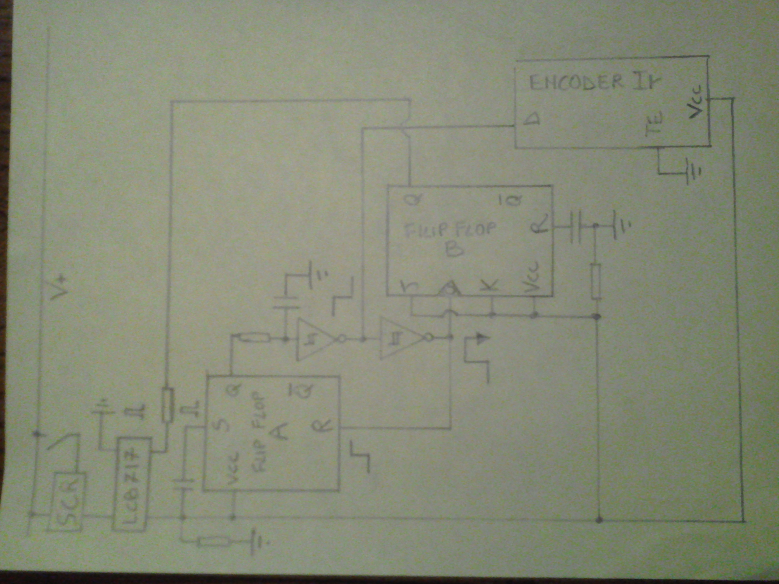

I'm thinking about a circuit but I need some support. I have to bring the VCC power to the flip flop and at the same time, using the same track, activate the SET input of the flip flop. what can you use? I guess it takes a slight delay between power and input. I thought of a chain of buffers on the input.
It sounds like you want the power up default state of the FF to be set (Q output high)
This can be easily done with a Resistor-Capacitor network connected to the set input pin. But the configuration depends on what FF you are using.
What's the part number of your flip-flop?
this simplified scheme is what I thought. everything is powered by stylus batteries.
an SCR in series with a normally closed OPTOmos (lcb717).
flip flop A is an SR, the other flip flop B clocked on the falling edge.
scr and optomos have the task of turning the circuit on and off, to use it only when needed. the reasons are two, to consume less energy and to obtain the repeat function when the button is pressed.
What do you think ?

- What are "stylus batteries?"
- You have the capacitor that I mentioned on the S pin of flip flop A, but you need a resistor to ground on that pin to pull it low after power on. The C you've got on the R pin of flip flop B is wrong. What is it's purpose?
- What is the purpose of the SCR?
- What is the operating voltage of the circuit?
- What are the spec's of the encoder? Please post a link to it's datasheet.
When drawing a schematic, always put reference designators on all parts. It's a lot easier to comment if there are part numbers.
Also, clearly show the function of all pins on all components. The input and output of the LCB717 are not clear.

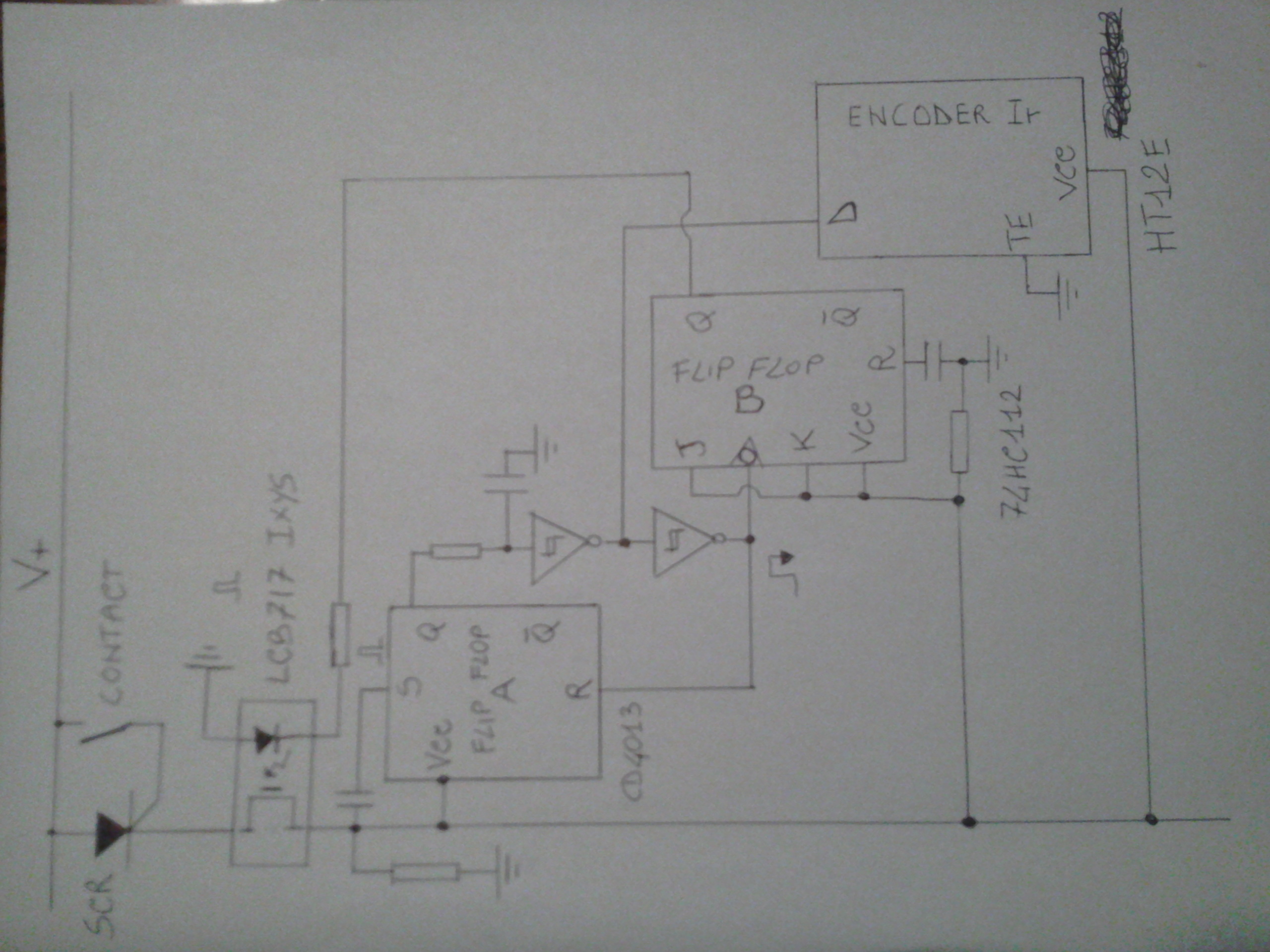

I answer the questions in the right order.
AA battery. two or three, I don't know yet.
the resistor on pin S of flip flop A (any SR flip flop) is present on the drawing maybe if you download the image on the PC you will see.
the capacitor on pin R of flip flop B (74HC112).
it has the function of supplying a negative impulse to obtain the reset.
the purpose of the SCR together with the OPTOMOS (LCB717)
there are two: operate the circuit only when needed to make the AA batteries last a long time.
achieve the repeat effect when pressing and holding the button contact.
the operating voltage depends on the voltage drop of the SCR and optomos, at least it is at least 1.2 volts, so I will probably have to use three AA batteries.
I have not yet chosen which IR encoder to use but the design was made based on HT12E.
which is what I know more than others.
tell me if it is still necessary to redo the drawing.

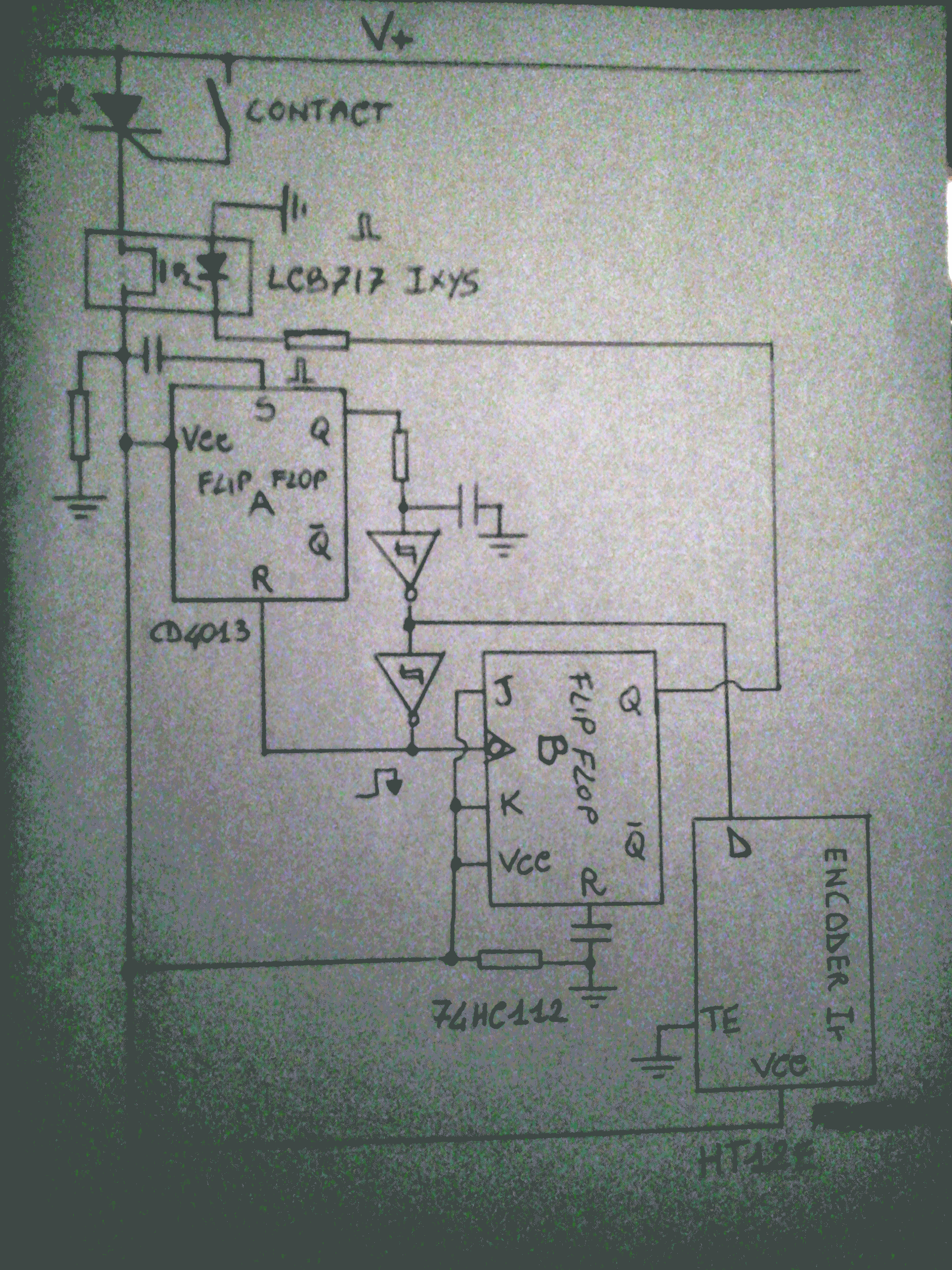

Hi.
this is the photo my mobile phone takes, I can't do more.
I have some questions.
1) I used the simplest of oscillators, port 40106 resistor and capacitor.
what other oscillator can you use that has the maximum stability characteristic?
2) as an alternative to OPTOmos lcb717 is it possible to use the Analog Switches?. For example this? :
keep in mind that when the circuit is off its input is floating.
3) on flip flop A:
is it preferable to use the SET input or the J input?
