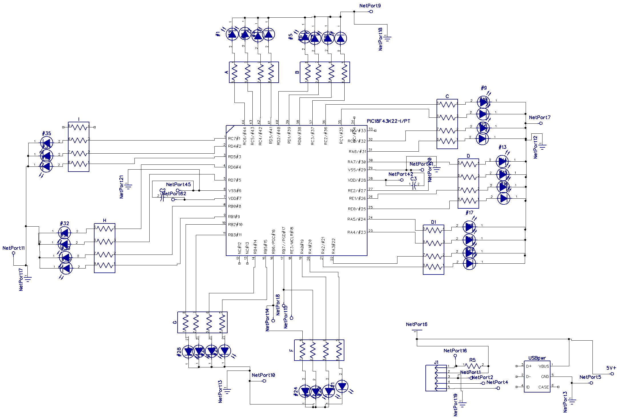

here is the schematic. Suggest using 330 resistorarrays in 1206 pattern.
Sorry I don't do KIDCAD. If you order boards using the gerber files I posted you should be fine.the leds are 1206 package as well'

I have no idea what software you're using to create schematics, but you seem to have different names for the same net????
For example, the "5V+" net appears to also be labeled NetPort6, NetPort1, NetPort42 and NetPort62.
Same thing with the GND net. How in the world do you verify that things are connected correctly?
Doesn't your software complain about the same net having different names? If not, you need to trash it and get something better.
The connection to MCLR/R5 looks to be incorrect, but who could follow that mess?

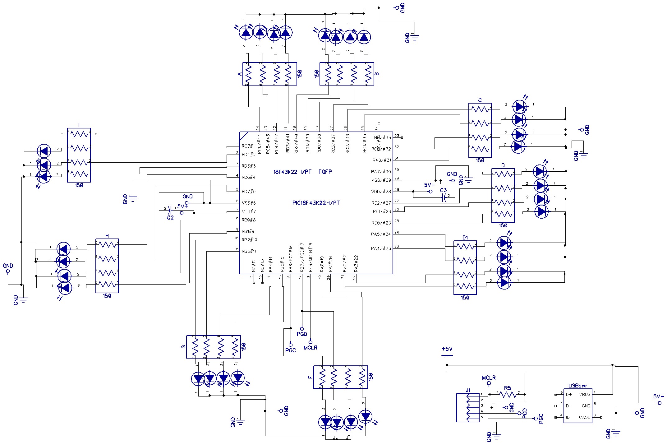

I posted the wrong file here is my latest file using 0805 leds
I had a harddrive issue and still trying to get files for diptrace correct folder. I have tooo many files that are same but minor changes.
Well, that's a little better.
So your nodes labeled "+5V" and "5V+" are the same?
Maybe "+5V" is some sort of single pin part/test point or something?
they are bacally Vcc. In the schematic they both highlite at same time.
Your new nick name is EAGLE EYE
