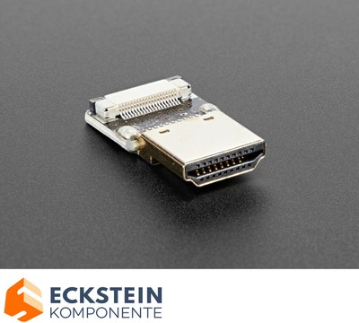

ps. Note that you can buy connectors such as these on ebay, to avoid using a full size HDMI cable in a small device:
They link using flexible flat ribbon.

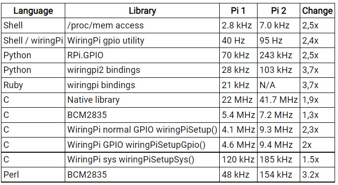

Found this data for the Pi 1 and Pi 2. We know Pi 3 & 4 are faster. This table gives me the idea that even on a Pi 4 you will never get close to 1mhz using Python.

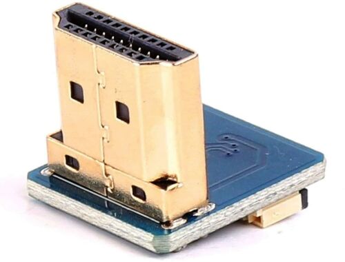

According to your table, the C language appears to be the more efficient language.
The problem is that Python is an interpreted language, so it's VERY, VERY slow compared to a compiler like C - really any decently designed and written compiler should be a fairly similar speed to C, dependent really on how good the optimisation is.
A compiler produces machine code, which the machine then runs, so it's effectively written in (relatively poor) machine code.
For those who remember the old Commodore Amiga (one of the best computers ever), it's OS (which was similar to UNIX) was written using C - and a number of enthusiasts got together and rewrote much of the OS routines in native machine code instead, this reduced the size of the OS routines to something like a quarter of the C compiled versions, and they ran 4 or 5 times faster.
