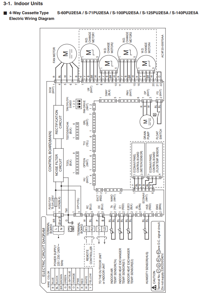

Hi all, i'm very new with electronics, looking to get a better understanding.
I work as a HVACR tech and I've been looking into making an Arduino thermostat to use mainly on Panasonic's ducted inverter A/C.
The issue i'm facing is that i don't know how the controller talks to the indoor PCB, there's 2 wires and they connect to terminals "R1, R2" which is between 12v-16v DC. I understand that it sends 12v DC to power the thermostat but is there some kind of Pulse width modulation to communicate with the system ?
If we can figure out how the RC communicates with the PCB then it should be possible to make an Arduino communicate also.
I've included some data sheets.
Any suggestions on this will be greatly appreciated

From those diagrams, both units have their own power so the interconnection is most likely data-only.
The diagram shows the connection as two core plus screen, so there is also a common 0V link between the units.
Possibly RS485, or CAN bus, though it could be their own unique system.

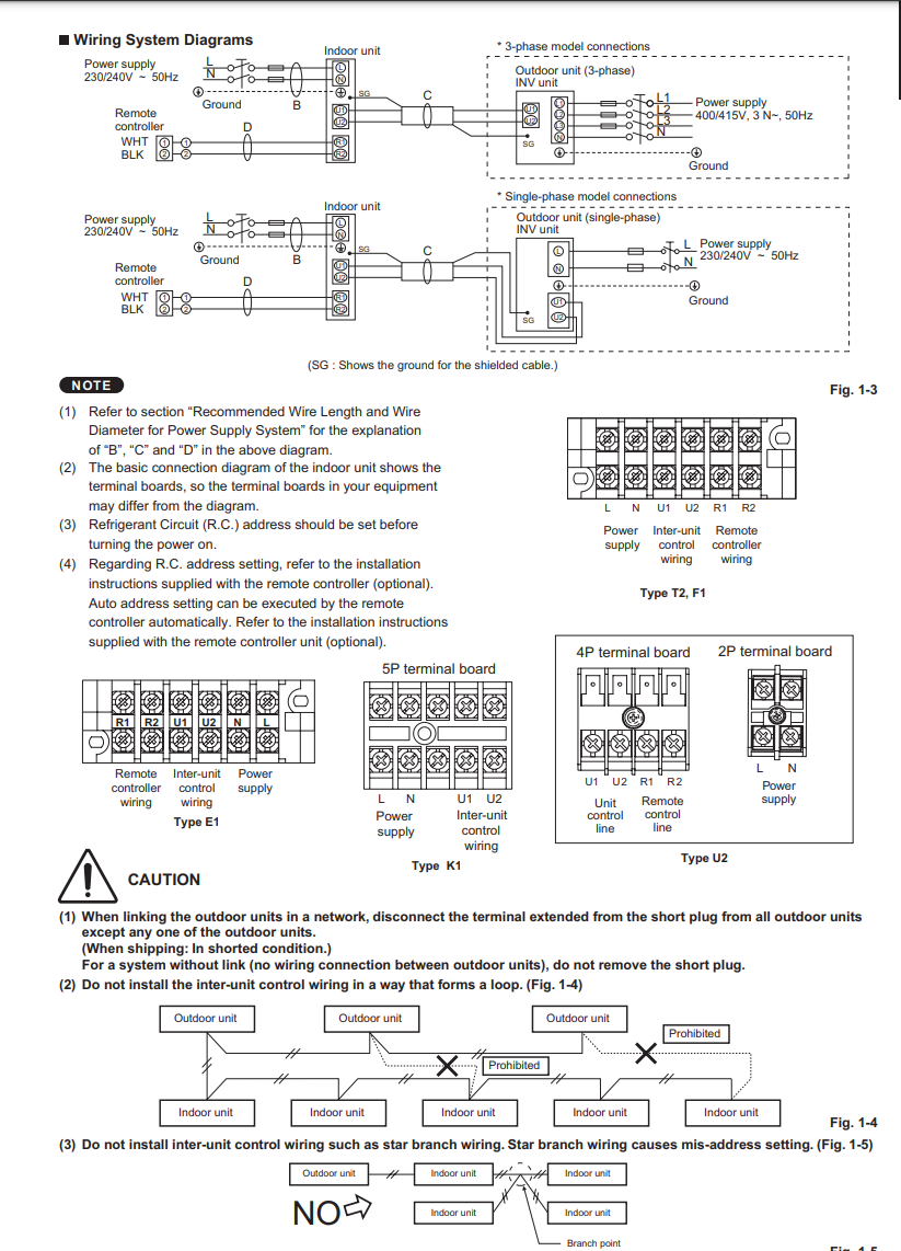

The datasheet says the devices have to be connected in a daisy chain (no loops, no branches of the bus) - not a requirement of CAN Bus. Each unit has a R1/R2 input and U1/U2 output to the next unit in the daisy chain - the datasheet says branches cause addressing issues so I assume each unit gets an address assigned dynamically on system power-up.
Look again - the indoor <> outdoor unit link is on the U1-U2 terminals of both.
The R bus is for a wired remote control panel / thermostat, rather than main unit interconnections.
A page for a commercial large system interface, which gives the limit as 64 indoor units and 30 outdoor units on each U bus network:
An from the same place, a home automation interface that uses the R bus:
