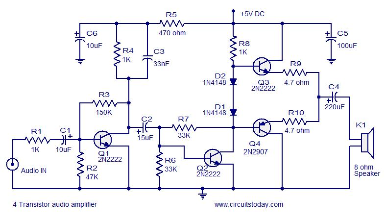

Distortion in darlington amplifier
I meant I did not see any _visual_ distortions on the scope screen.
That can still mean a high harmonic distortion of several percent, well above a typical HiFi standard of <<1%, but may be tolerable for listening to AM radio.
Totally down with that, cpt.Wally, I am just wondering what it has to do with a bold statement "There's still a LOT wrong with that circuit" of our esteemed pointy-haired boss?
You did not see distortion because C3 was cutting all the high frequency distortion harmonics. C3 also cut high frequency audio making the amplifier muffled like an old AM radio.
I fixed it and got an output power 5 times more than before. The output power is still very low because the power supply voltage is very low.
Bootstrapping is when the output reaches down with C7 ands pulls up the bootstrap voltage on R8 and R14 allowing a higher output signal swing.

Your first simulation shows gain factor of 200 on 3 mv input with some distortion (original circuit) and a second one - gain factor of 17 ('improved' one)
In fact, original circuit shows gain 1000 of 1 mV input without any distortion. If the initial conditions mismatch that big, there is no reason to trust any further calculations.
And you still did not respond - so, are you saying emitters should be just connected? 0.22ohm is ridiculous.
And just noticed - you simulation has an error.
C3 is NOT connected to the ground in original circuit. So dump your results and start over.
1) The "bass boost" for an LM386 amplifier IC does not boost low frequencies. Instead it cuts the gain of high frequencies which can result in instability if the reduced gain is less than 9 times.
2) Most amplifiers produce low distortion at low output levels My simulation of the original "horrible" circuit at maximum output level shows the top of the waveform is squashed which is horrible distortion.
3) Look at many of the amplifiers at Elliot Sound Products to see 0.22 ohm emitter resistors.
4) Yes, C3 was in the wrong location in my simulation. In the original location where it cuts high frequencies it causes much more distortion.

So my next question is - can you please explain the purpose of R9&R10?
Most example diagrams of this type show direct connection of emitters.
Do they have anything with limiting output current and power consumption or is there something more sophisticated to it?
R9 and R10 should be 0.22 to 0.47 ohms to help match the output transistors for lowest distortion. For an old AM radio then they are not needed.
The value of 4.7 ohms is much too high since it throws away a lot of output power.

After I removed R8&R9, Ic current of Q4 is 320ma without any input, and both Q4 & Q3 are getting hot as hell. Just sitting at rest, Carl!
Did it ever happened to you to assemble anything using your hands, or you just enjoy the bliss of simulations?
BTW, Imax for 2N2907 is 600 mA, not 800. 800 is for its neighbor. Heard about bottlenecks?
From 2N2907 specs I can see that optimal Ic is around ~100 mA.
Now I do understand what R8 and R9 are for. Reasonable compromise between gain and consumption/thermal conditions.

Here's an example of a four transistor amplifier - actually from an HMV radiogram from 1969 - so it's a little more complicated than a radio one would be, but essentially the identical basic circuit. Because it's so old it's germanium and PNP, so it's 'upside down' compared to yours.
Your R8 is 42 and 44 in this circuit, and is bootstrapped via capacitor 22.
Most have emitter resistors, it's crucial to stop thermal runaway, it would be a rare (and really poorly designed) one which didn't.
As above, they are crucial components to prevent thermal runaway and keep the amplifier working. In this poor example they are much too high, as a consequence of all the other poor design. Personally I'd never use a pair of diodes to try and set the quiescent current, I'd always use a Vbe multiplier (another transistor) which allows you to accurately set the quiescent. The 1969 circuit I've just posted shows a 'resistor' doing the job - but I suspect it it's actually a thermistor, which was commonly used for that purpose back then. 'Some' old circuits did use diodes, but these were special diodes selected for the job, and not a bog-standard IN4148. Because of that, they are using excessively high emitter resistors.
Essentially you're looking for thermal stability, and the diodes/transistor/thermistor should be mounted on the same heatsink as the output transistors to ensure that.

Antique 2N2222 and 2N2907 transistors in the old metal case might not match the thermal characteristics of modern 1N4148 diodes. Use them with modern P packages.
Do you know why 1N4148 diodes are used to bias the output transistors instead of using resistors? Because the diodes match the voltage and temperature changes of the output transistors.
The output transistors have "thermal runaway", as they warm up they conduct more which makes them hotter which makes them conduct more which makes them hotter which makes them conduct more .....
The forward voltage of the diodes should match the Vbe of the transistors and if the diodes get hot then they reduce their forward voltage which reduces the current in the output transistors if the diodes are bonded to the output transistors. Then there is no thermal runaway.
