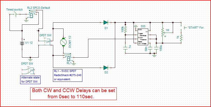

Delay ON, using a 555 and 12v motor
Bob,
I have a question for you and I am sure you did it your way for a reason, but I wanted to know why to better help me understand circuits.. Take a look at my .pdf... What would happen if we eliminated the lower 555 and tied the diode in this way?
Good question!
Woke up this AM wondering the same thing.
With the 555 configured as a "one-shot" monostable, there is the need to either re-trigger the circuit or power it down to effect a reset.
I haven't breadboarded these circuits (SIM only) but I'm confident they work. My concern was the transition time of the DPDT switch (the "off" period during the CW and CCW selections). I am uncertain that there would be an adequate power-off period for the 555(s) to "reset" and again produce the delay pulse.
I tried this in the SIM:
It took a minimum 150ms Timed Switch duration (thereby turning off power to the rest of the circuit) to effectively reset the 555. Any shorter duration failed to produce the reset. Of course, some of this time may have been a result of the inherent SIM speed. I don't know thw transition speed of the DPDT switch. I'll test a real switch's period later this morning.
Anyway, in the meantime, there's certainly no harm in wiring it as you suggest and trying it out.

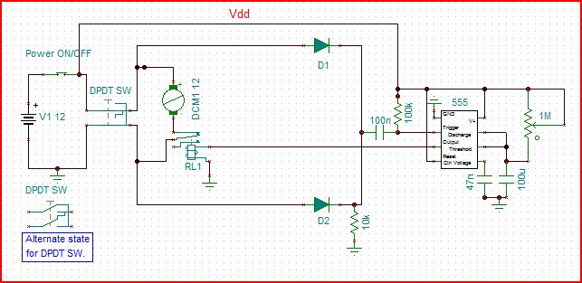

Jeremy, your modified circuit won't be able to retrigger (the 1uF capacitor on the trigger pin will remain high after the initial relay activation). You could try something like the following mod. It relies on the DPDT switch being a break-before-make type, which will allow a small low pulse to be fed into the trigger pin when the motor hits an endstop and toggles the switch.
Interesting concept, dougy83. I understand your intent.
I assume you meant to leave the link from D1 to the Vdd rail of the 555, since otherwise there would be no power applied to the 555 circuit.
That toggle transition you wish to exploit might work except that during that transition the 555 also loses power, pretty much making the low going (see below) trigger generated ineffectual. It's that power loss I was trying to exploit as well, except as a total 555 reset.
Also, keep in mind that the absence of a + voltage doesn't equal a "hard" negative transition (to ground, ideally) that would trigger the 555.
I wrote "12V" on the power to the 555 to indicate that it is powered continuously.
The pull-down for the trigger is provided by the 10k resistor to ground.

dougy83, I stand corrected, with your noting of your power explanation. Your mod will work if the toggle transition time is short enough. In the SIM, 150ms was too short, 200ms worked. We'll just have to see with whatever JeremyA uses for the DPDT switch.
Not sure what you mean. 150ms will be the same as 200ms will be the same as 20ms. The 100nF/100k filters out pulses longer than 11ms anyway. A very short trigger pulse is fine, and so is a very long one.

JeremyA, here's a final schematic using dougy83's (considerably more elegant) mods (notice I removed the "start" circuit as well):
This circuit will have NO delay at power-up and, after re-reading your original 1st post, is what I now think you wanted in the first place.
You are correct. No delay at start up, only on toggle opposite. Thank you. I can't wait to try this out on my breadboard! I can't thank either of you enough for the thought that went in to designing this circuit. Means a lot to a noob.
Add this diode (which I forgot to include [a 1n4004 will do]) - it protects the 555 from the reverse current inductive "kick" of the relay when it is de-energized:
