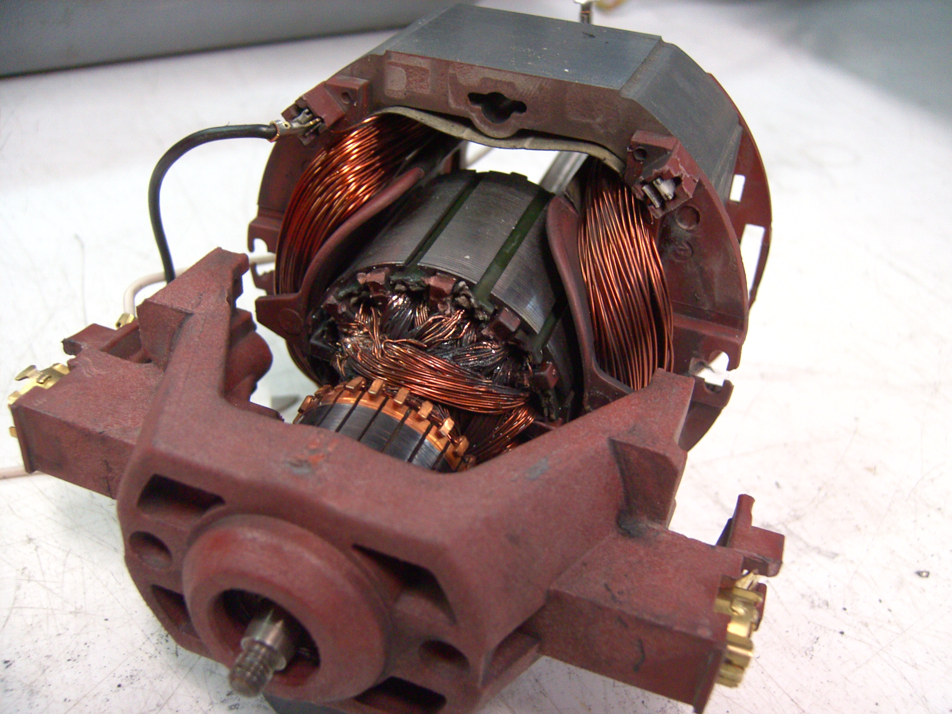

I was trying to figure out if I could take the central shaft out of a car heater blower motor (dc) and put it into the housing of a fan motor (ac). Would that still work and, if so, would I need ac or dc power? I tried looking it up but found nothing to answer my question.

An AC induction motor requires the squirrel cage rotor, this consists of conductive bars imbedded into the rotor.
These represent shorted turns which provide the attraction required to the rotating field in the stator.
You intend to use a wound brushed rotor, the only way this would work work is to turn it into a series field (Universal) motor which would not be practical without rewinding the stator.
A DC (or universal) motor armature works against a magnetic field oriented across at 90' to the line of the brushes.
(Or 45' if it's a four brush motor etc).
So your blower motor needs a field with one pair of north-south poles, and the brushholders fitted in the correct relative position.
That AC stator looks as if it may have three pairs of poles? Very difficult to be sure but the binding looks vaguely hexagonal.
Either way, that stator (like most AC induction motors) is intender to create a rotating field that induces current in the rotor.
Its a very different type of operation to a brushed DC motor.
If you short out the entire commutator on the DC armature, it may work as an AC induction motor, but probably not anywhere near as efficiently as with the original purpose made "squirrel cage" rotor.
I was writing this as rjenkinsgb posted, and is says much the same.
If it's a 2 pole ac stator, so designed to run near 3000 rpm (50 Hz) or 3600 rpm (60 Hz) then you could make it into a universal (ac or dc) motor by connecting one phase of the windings in series with the brushes. The rotor would be used as is. You would have to rotate the brush holder to find the angle that gives the most torque, and fix the brush holder there. It wouldn't be a very good motor.
That rotor is a 2-pole rotor, as it is designed to be contacted with two brushes, and it creates two poles, N and S, around it. That could work with a 2-pole stator.
A lower speed induction motor would be 4 pole, so that it creates 4 poles, N - S - N - S, around the rotor. That would only create torque with a 4-pole stator.
You could also short out all the commutator segments and run it as an induction motor with no brushes. That would run on ac and would be worse than the original squirrel cage rotor.
Sorry, half asleep, pre-coffee!
The brushes are on the SAME line as through the field magnetic polepieces... The armature field is created 90' to the brushes, or half way between with higher brush counts.
This illustrates the two field poles needed for a two brush armature; if they were permanent magnets rather than wound field coils, the arrangement would be similar.
Having a wound field on a "DC" style motor means the strength and direction of the field can be varied.
If both the field windings and armature (via the brushes) are combined on the same supply with the field, both reverse polarity if the supply polarity is reversed, so the direction of rotation stays the same.
With a typical electric drill or small appliance "series" field type motor, the field windings are connected in series with the brushes. That makes a "Universal" motor that works on AC or DC.

But back to the topic, the operation of AC and DC motors is fundamentally different. Absolutely and completely.
There is only one type of motor, the series wound or universal motor, which can operate with both currents.
You could not use the AC motor stator as-is for a Universal AC/DC (series field) motor.
The Universal stator has to posses two distinct separate poles as opposed to the overlapping AC version.
A parallel, or shunt field DC motor will not work on AC as its series version does.
