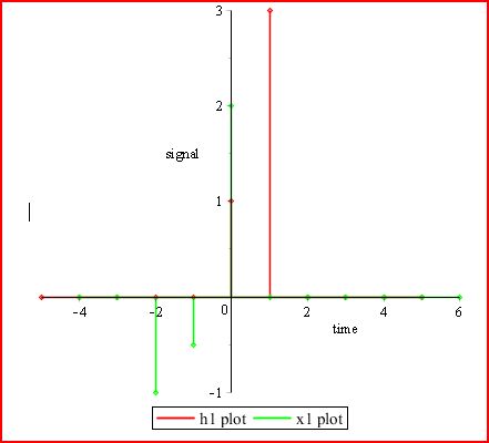

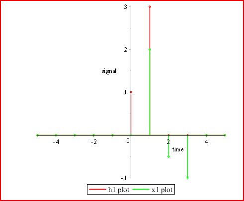

I looked over the problem and yes, your calculations are correct. Below is a graph of h1 and x1.
Next x1 rotated around the y-axis.
Now we start moving x1 into h1 and calculate the intersection of the two curves.
The process continues until x1 no longer intercepts h1. Congratulations on a corrrect answer.
