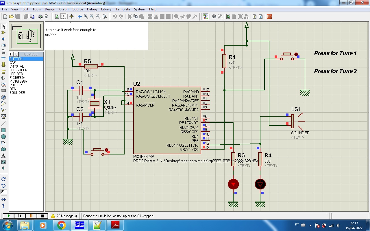

I'm simulating on Proteus, the 16f84 is ok, the 16f628 is in a loop with the ptt activated and with a beep or CW on and off continuously.

Your second image is not the latest code that Terry posted as it doesn't have the BANKSEL code. It looks like the original 84 code.
Actually, that code needs to be changed to,
ReadEE
        bsf     STATUS,RP0      ;select bank 1
        movwf   EEADR           ;EEADR = w
        bsf     EECON1,RD       ;read EEPROM
        movf    EEDATA,w        ;get EEDATA into w
        bcf     STATUS,RP0      ;select bank 0
        return
I'm guessing that the RP0 code was inserted by Ian and Terry didn't spot it.

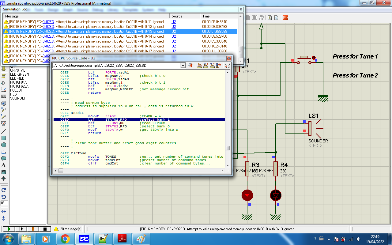

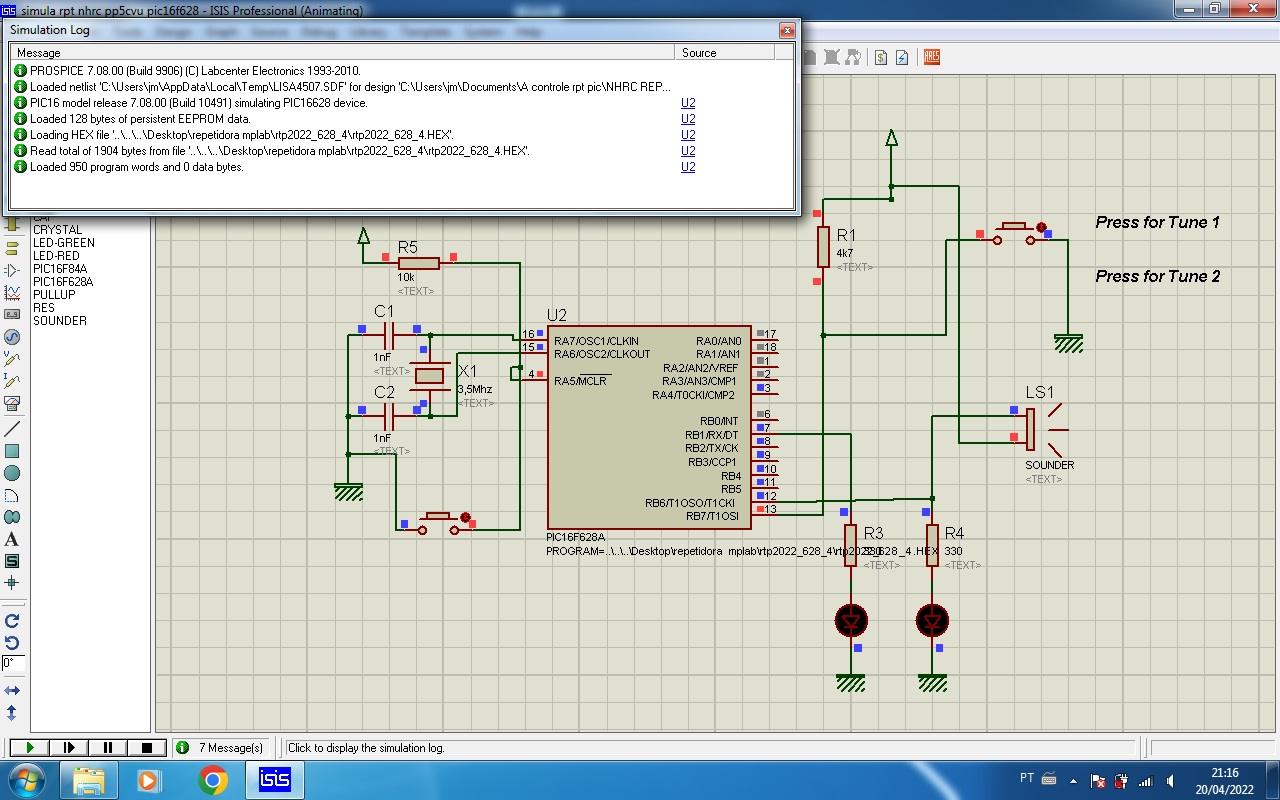

Terry with his last file, the program does not report an error but does not turn on the led or beep when I activate the COR. Previous versions up to 3 stay in the loop, 4 and 5 do not loop but do not turn on the leds in the simulator.

Terry, that file still has,
; Read EEPROM byte
; address is supplied in W on call, data is returned in w
ReadEE
    BANKSEL    EEADR
    BANKSEL    PORTA
        return
Which is not going to work because EEDATA is in bank 1.

Try this one Jaison.
  • rtp2022_628_5.asm
Bingo Gentlemen, Terry, Pommie and other colleagues for congratulations. Initial test ok, I will try the commands via DTMF to complete the test.
