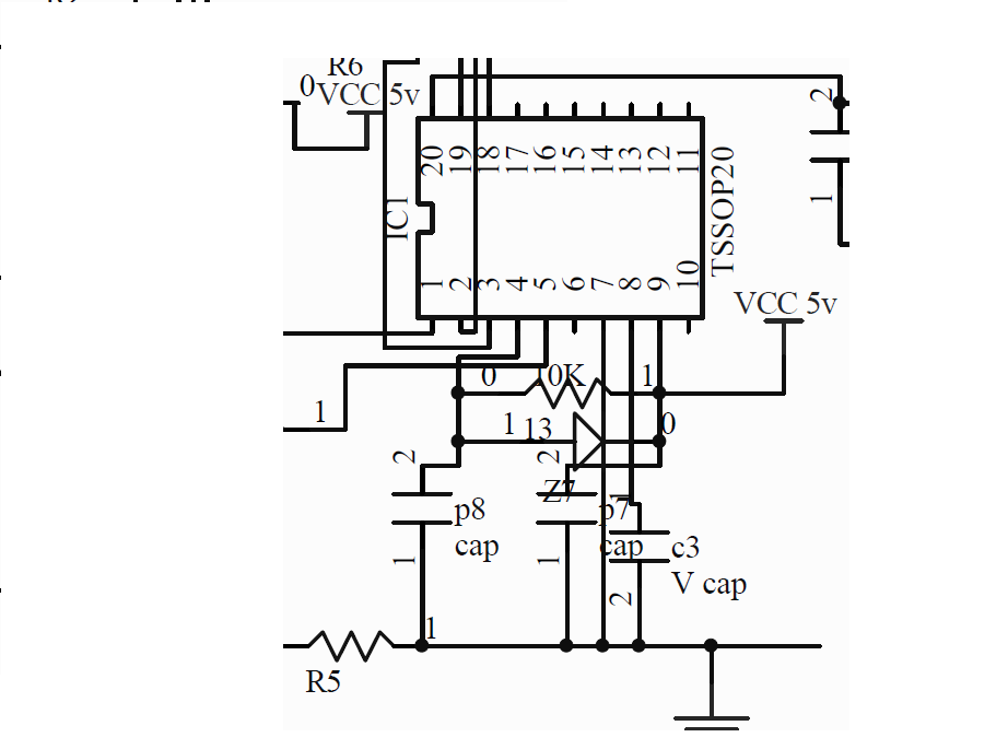

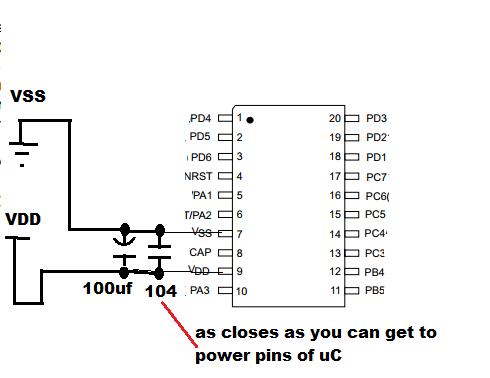

Forgive me if I'm wrong but what st micro are you using cause if the TSSOP20 is it it's not going to work as you have it on the sch.
You need something like this on power rail
All we have is the schematic, not the board. I've seen decoupling caps put almost anywhere on the schematic, including up in some isolated corner.
That is not to disagree that they should be very close to the requisite pins. Please note, your 100 uF capacitor seems to be reversed.
Edit: Now the polarity of the electrolytic capacitor in post #30 has been fixed.
I fixed that I forgot the flip it top to bottom
But this mess will not work I help someone fix this almost same problem .
The power rail needs to run parallel with the caps across it 104 and 100uf works well
then if needed add a zener diode to clamp the power to 5 volts a head of the caps.

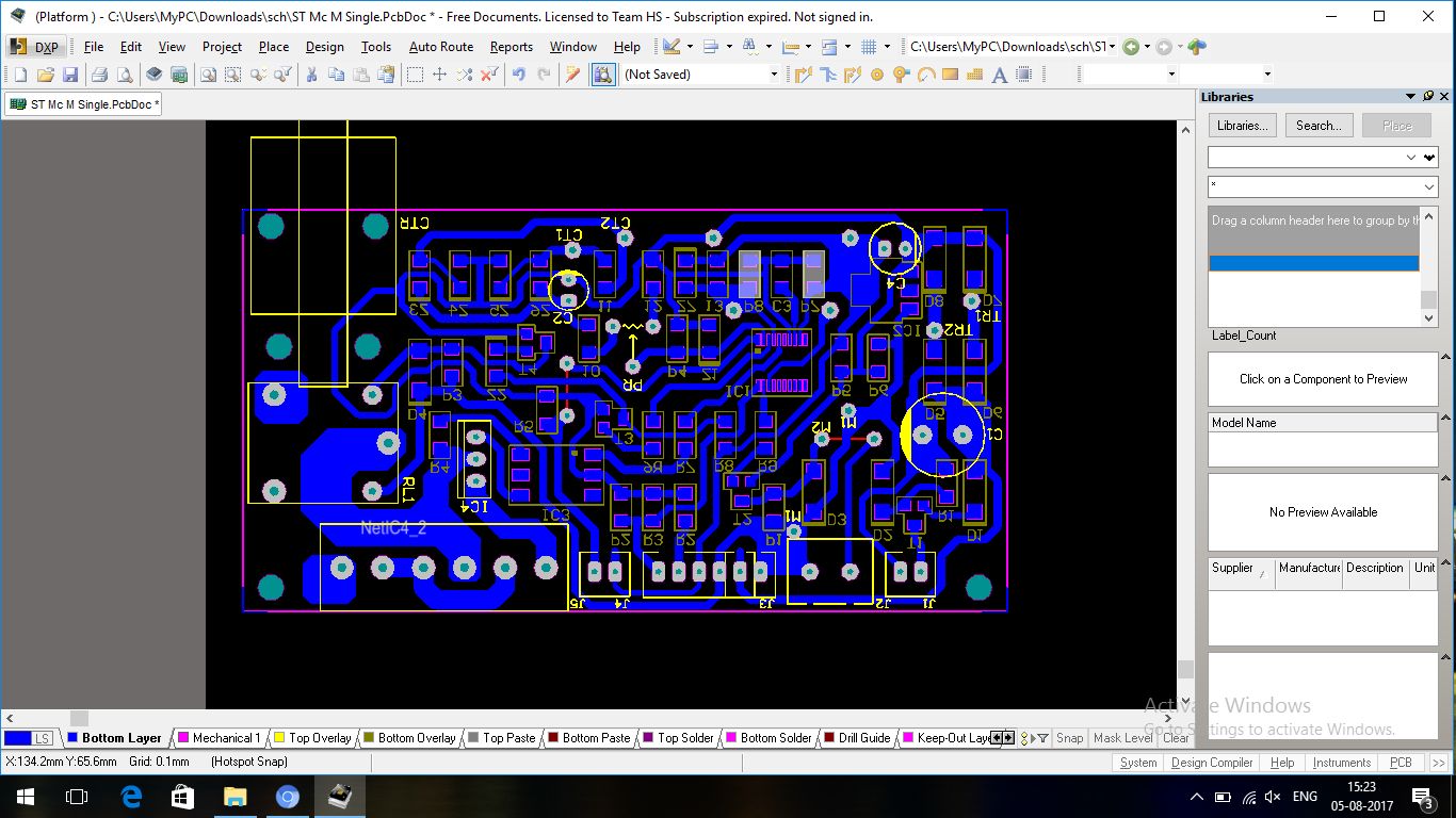

The board layout was posted in post #4 above.
Not in any format I could understand or view. The PDF is unlabeled.
Perhaps, if you could circle and label p7 in that image it would save us all a lot of time.

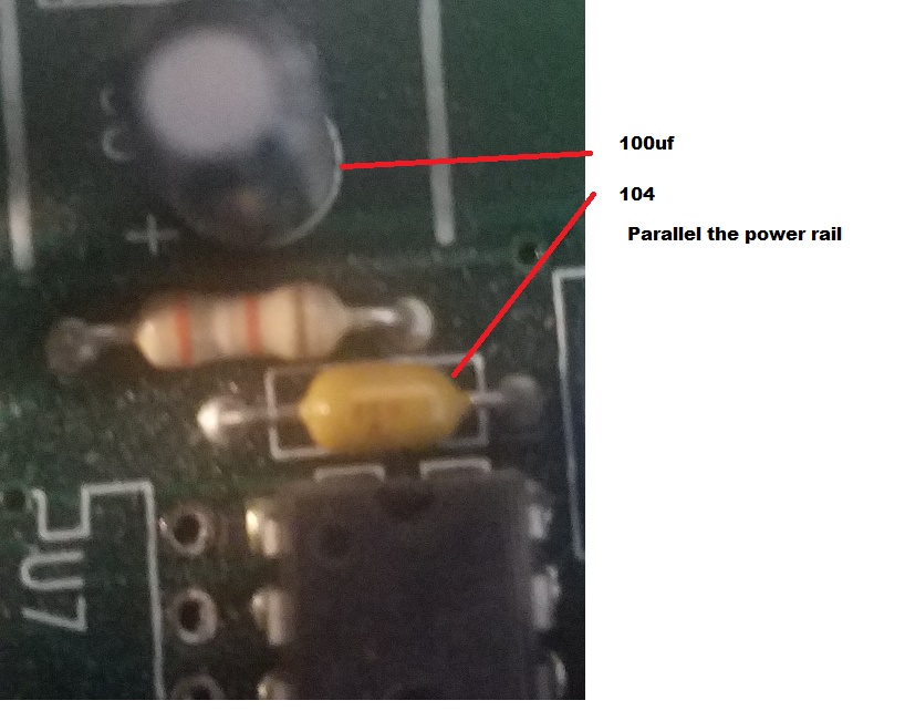

The board doesn't have caps in right place. Like I said I helped fix this same problem but they was using a pic 12f chip
Here something I had laying around that shows good layout of caps.
Sorry to all for late response. I have posted screenshot of the PCB design, in which P7 and P8 capacitors are highlighted.
We have replaced p8 by a through hole 10/50 capacitor, and 1117 regulator IC by 7805 and found that the frequency of reset is decreased.
Also, we have made a single sided PCB in which all the components are the same as that shown in the design but are placed on one side of the PCB and that circuit is working properly.
