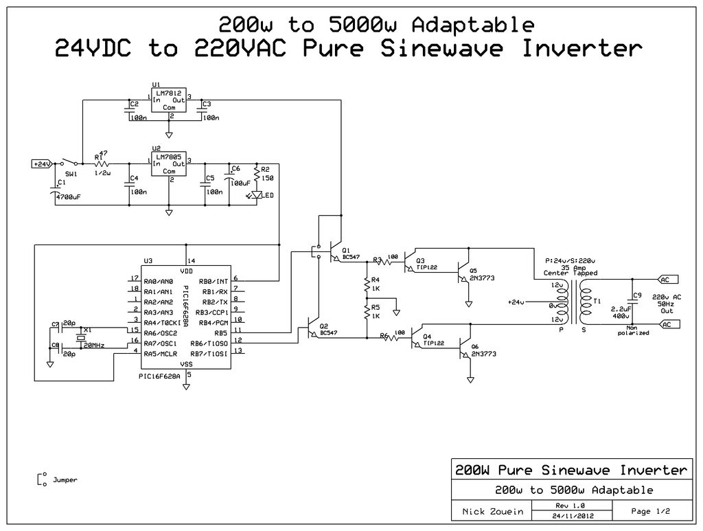

Being my first post here, I'll say that my experience in electronics is quite lengthy, however, my coding experience is so old, that I doubt it will help much (Fortran days). I picked up a diagram that I've attached, and the hex code that was given for a 50hz signal. What would be the best way for me to start figuring this out. Basically I have no idea where to start.
Any directions you could give will be more than appreciated!

The easiest way would be to use a 24MHz crystal - a little overclocked though. However, feeding 24V into a 12V winding doesn't seem like a good idea. I also don't see how you get a pure sine wave using a pic like that!
Do you really need 24mc's to get a sine output.
With a simple filter on the o/p of the pic you ought to be able to get a nice clean sine esp at 50 cycles.
pomms has a point, your schem would give 440v, I think you mean a 48v transformer, ie 24-0-24, as when you swing a tranny either side of the centre tap like your doing you effectively double the ingoing voltage.
They tried to teach me fortran at school, but I was more interested in listening to heavy metal.
You don't need 24MHz to get a sign wave but to use 50Hz code at 60Hz you need to clock the pic faster - changing the crystal does this without even knowing what the code does. To switch two digital pins to produce a pure sine wave is quite tricky and the hex file seems too small for that. I wouldn't be surprised if the pic just outputs two anti-phase square waves.
That' what the scope showed

Someones mixed up, the crystal controls the rate at which the program runs, and is critical to the o/p freq, as pomms says changing the xtal by a % changes the o/p freq by the same %.
If its moddified sine wave (all those retlw's in the code would suggest that its either pwm or r2r), or should I say crude square wave you'll have issues with start up current, you'll probably need some sort of soft start to keep startup current down, unless its a fancy tranny.

Maybe its an approximation of a sine or something.
I've never attempted anyhting like this, cheap chinese imports make it unrealistic.
Hi be80be
Is that 60Hz code for Nick inverter?
If I am correct PIC is chopping sine into PWM pulses.
I though of using 24mhz crystal, but it is to fast for PIC 20Mhz max.
Can I use 16HV540 for it supply voltage 3-15v and drive single mosfet per side of transformer for 300W.
zvizdic,
Yes.....that is the code from Nick's post. I went ahead and tried the 24mhz crystal, and it seemed to work fine. The wave is really pretty smooth for a fax pwm, and comes in at just under 60hz. I just have not posted this either on this forum or on Nick's Inscrutable yet. I am working on the hex file, and should have something soon, as I wouldn't put a lot of weight on using the circuit as is. There is a fellow named Tim Nolan that put together a nice set up, using an Atmel MCU....one of the AT90PWM's and a ATTiny-45. Just put his name in a search and add the words grid connect. He's got all the code there, and they look very good.
Output circuit is a bit odd. NPN transistors Q1 and Q2 have their collectors directly connected to the 12 volt output from U1, but their bases are driven directly from the PIC output so the emitters can never be at a voltage higher than Vdd-Vbe.
Unless I'm missing something the 12 volt supply serves no purpose, the collectors of Q1 and Q2 may as well connect to the 5 volt output of U2 :confused:
Yep, and the TIP122 are a darlington i think so the output stage is a "trilington" with emitter at ground, so the PIC output would have plenty of voltage and current to directly drive the output trilingtons.
R3 and R6 have to need at all to be 100 ohms to drive trilingtons! It looks like someone has adapted from another circuit and not known how it works.
