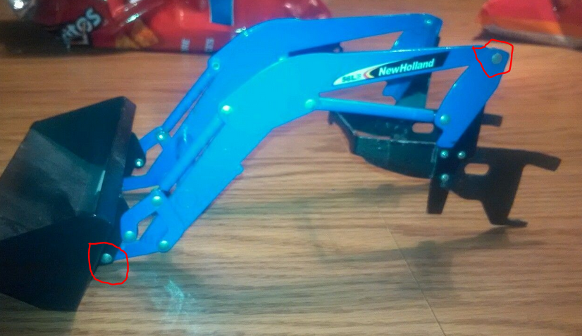

I need to measure two joints, circled in red on this model:
John
I use two angle sensors on excavators to get similar information.... We put one on the first section ( before the first joint ) and one after to get the second sections angle... BUT!! you are looking for the angle of the bucket... This can be done with simple potentiometers... I only need to know the position of the bucket, not its angle.....
Do you use angle sensors or accelerometers? I recall you linking to some accelerometers with which you had experience earlier. For my tractor, the inherent bounce was too much for the accelerometer-- or at least more than I wanted (±2° or so).
The tractor pivots are pretty crude compared to my excavator's. They look like seamless, welded tubing with a half-hard or alloy steel pin. I was thinking of mounting the magnet in the pin opposite the zerk grease fitting. Then mounting the electronics in something like a bearing cap pressed into or over the tubing. Since this is very early in the design, I need to avoid any modifications to the tractor that are not completely reversible. In other words, if I bore out a pin to take a magnet, I could leave the pin as is or replace it with a new pin, should that be necessary. But, I am not going to be drilling any mounting holes in frame members. I will just use mounting tape.
I haven't been able to get outdoors since my accident. I am thinking another week or two, and I will be able to start playing again with everything except ladders.
John
Accelerometers are in fact angle sensors.... The ones I use have inbuilt smoothing to enable you to use them as angle sensors... These are obviously dearer than accelerometers as they only have X, Y and Z information...
As I have posted before.. They are £30+ but work for me.... Coupling an accelerometer requires the maths to determine the angle.... Loads on the internet have done this... If you trawl the arduino sites you'll find code.. Unfortunate in C++ so a bit of work, as you use assembly!!
A pot and an arm would suffice just as well....
