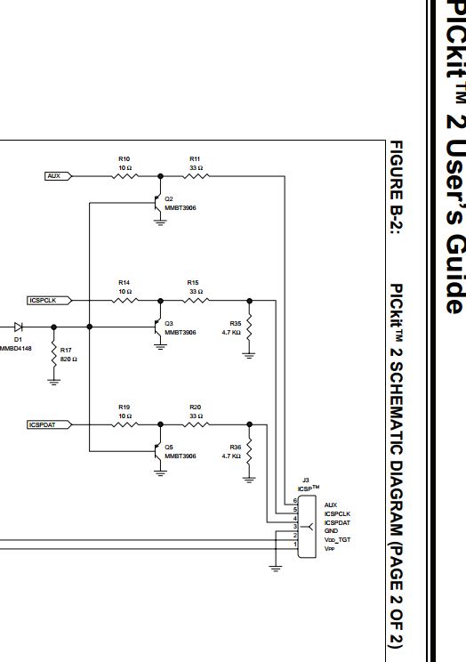

As Ian says, even a basic diy pickit2 will do, like bluerooms circuit , you just have to add an extra line from the output connector pin 6 * to RA4 via a 39R resistor to get the third LA input.
* pin6 as shown on the original Pk2 User Manual schematic

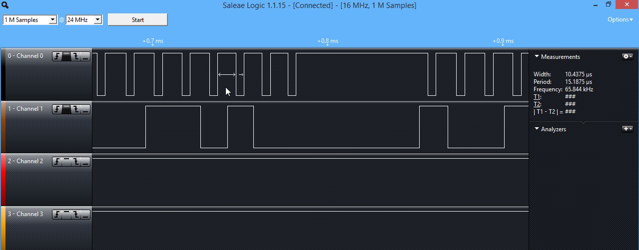

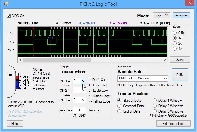

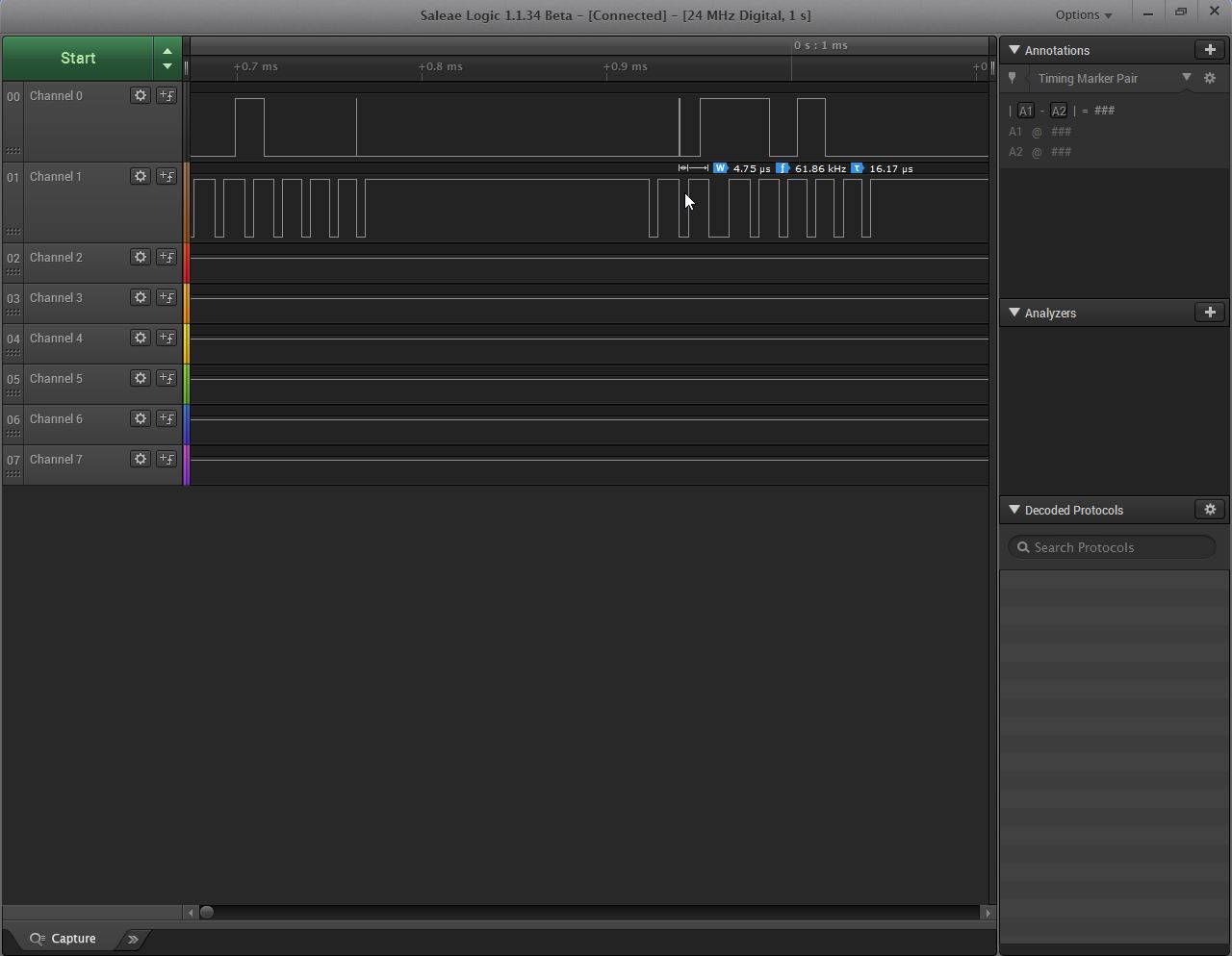

John,
You seemed to be looking at mid range analyzers , though not sure if you are still going to get one ?
I'm also a novice with LAs, and have only tried the LA function within the PK2, which does work but seems very limited.
Decided to get one of those ebay $10 clones which runs on the free Saleae software.
Thought you might be interested to see my first views with both devices, its just monitoring the Serial Out and Clock spi signals from an Arduino to lcd.
Its just the simple monitoring of the two lines, have still to try the Protocol Analyzer functions.
The PK2 LA is very basic but it also has the Logic Tool facility to set and test i/o lines.
There are two shots of the Saleae software v 1.15 that the clones say to use, but seems it also works with the latest v 1.34.
Both clearly way ahead of the Pk2 in features and the obvious fact you can see the signals clearly on a full screen.
As I you probably have already found you can download the Saleae software and run it without the actual hardware box by using its inbuilt Simulate function to see how it works.
