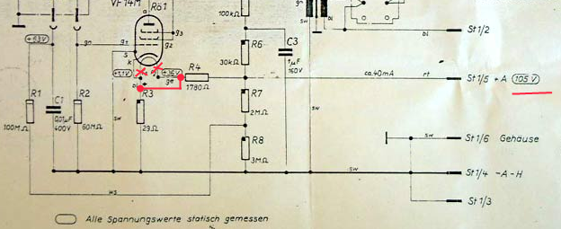

Hello guys. I'm a long time lurker here and at first i want to thank U for great ideas. Here is my first question. i try to "design" current converter from unregulated r/c voltage source (5780ohm/200uf) . At the end of r/c voltage is 35V @ 40ma and I would like to convert it to 7v @ 130ma. At first it looks like job for simple buck converters but I have a problem because the load current is approx 250ma in cold condition (heater wire). I experimented with current limit circuits and LM2597 but it worked partially. In some situations Vin voltage drops under the buck safe vin and chip stuck untill next restart. I would be happy even with non regulated converter 5:1 ratio (transformer for dc) just to keep input current at 40ma even the Vin voltage changes like mains voltage changes :( any ideas where to start or how to improove LM2597?

**broken link removed** Hello again. No fancy things to draw but here is the schemo. My problem is that R/C has to be as it is. No mods are possible :(

Thanks guys. here is the original schematics. **broken link removed** The original tube use 36V for heating and I try to substitute it with some small available tubes with up to 125ma @ 6.3V. the 0,7V is used for current limit sense. Anyways, tube goes up to 200ma when start to heat but as soon it heat up it goes down to 125ma. Unfortunately I cant change the R7 and the surrounding components. Of course, everything around the buck or the buck can be replaced. BTW Mosfet as triode is not bad idea at all but I have no idea where to start :(
I think you can get parts with a 6.3V filament voltage and can not get a 36V filament.
It looks to me that:the 105V supply, and R4, R3 and the filament resistance makes a voltage divider to get 1.1V on (K).
So cut the filament out and change R4 or add a another resistor to get the same voltage divider.
Now with the filament not connected you can make the 6.3V any way you want.
I would probably use a "wall wort" or any small 6V power supplies.

I assume this is a hi input impedance microphone pre amp and the component KK47 is some form of capacitor microphone. Can yo conform this ?

Hi Les. My idea was to use 6cw4 nuvistor or similar. By measuring I found that filament is approx 125-130ma. Again, my idea was not to modify psu or internal layout/values but to substitute the tube with buck/tube because it will make possible to exchange this mod easilly with original tube (if I find it one day). Also, since nuvistor is in metal pack it's more immune to switching noise. Btw, I tried that with sucess withouth any noise in audio range because buck was used jut for heating. Tube bias was taken from high non regulated voltage.
Thats going to be quite tough, if the 1780 Ohm cannot move - but I did suggest adding another resistor in parallel to reduce its resistance :)
Also, if you disconnect the heater pin from the 29 ohm resistor, and connect it to ground via a 10R, you can connect the output of your buck directly to the heater+, and use the heater- resistor as the feedback to your buck. This will provide a constant current of 1.25 / 10 = 0.125 = 125mA. The price you pay is that, if the 'heated resistance' really is 50 ohms, you'll have a drop of (50 + 10)*0.125A = 7.5V.

I do not see a solution to your problem as you are trying to make a plug in replacement for the VF14M without making any change to the original circuit. My mosfet idea is no use as the gate to source capacitance would be too high.
I Think Ron Simpsons idea is probably the best way to go.
Just add an 845 Ohm resistor in series to ground with R4 to maintain your 40 mA.
