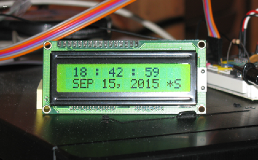

BTW, This code is to decipher the WWVB time signal. A $10 wall clock is the easy solution, but is not nearly as stimulating.
Interesting project, John.
How did you come to choose a WWVB project as opposed to a project using a cheapie Serial GPS module? Does it have something to do with your interest in radio, or did your interest in WWVB spark your interest in radio?
Hi Mike,
It was entirely my interest in radio -- I built my first transmitter (27.255 MHz, 1952-1953) in 4th grade for an RC plane . I did consider a GPS module, but it just didn't seem as fun to do. I am pretty close to posting an update but am not real happy with the part of my program that syncs with the WWVB start. It can take almost 5 minutes. I would like to get it to about half of that, i.e, 1 minute to identify the start of the sequence and another minute to capture a complete sequence of the six, 10-second frames. I am using a 12F683 to generate a simulated signal, so reception is not an issue.
Regards, John
That's very cool. May I ask which WWVB receiver you're using, and, how well does it work there near Cleveland?
No problem at all. You may have heard of the CMMR-6 receivers made by C-Max (https://www.sparkfun.com/datasheets/Wireless/General/CMMR-6P-A2-1.pdf ). Apparently, they are out of production; although, DigiKey still lists them as "non-stock" (**broken link removed** ). I called DigiKey and the service person was quite clear that they were not available and would not be on order.
I Googled and found that PV Electronics in the UK sells a similarly appearing receiver with a COB instead of IC: https://www.pvelectronics.co.uk/index.php?main_page=product_info&products_id=7 . The manufacturer is shown as Symtrik (symtrik.com). The main difference between Symtrik and CMMR-6 pictures is a non-populated SOIC-8 pattern on the Symtrik board. Pin 1 appears to go to VCC, Pin 8 goes to ground, Pin 5 goes to what appears to be the output transistor from the receiver. I have not carefully traced the circuit and do not know where Pin 4 goes. Is it MCLR for 12F6xx? I have not tried to contact that company yet. Here's a direct link to the Symtrik datasheet: https://www.pvelectronics.co.uk/rftime/SYM-RFT-XX.pdf The service from PV Electronics was OK. Transport and to a lesser extent shipping were not the fastest. USPS probably contributed to that delay significantly. It is a reputable company so far as I can tell and that receiver is just a very small part of its business. Compared to the option of destroying a wall clock, I liked the larger size, and I hope to be able to extract the carrier. In the Fall, I played around with building my own receiver based on several designs using common op-amps and a bandpass filter IC. I was receiving something, but decided it is better to start with a working receiver.
Reception with the standard ferrite antenna is sporadic during the afternoon and early evening in Cleveland. I got steady signal between midnight and 3 AM, but it was weak. The EMF from a Tek 210 'scope complete blanked it out. A much older CRT 'scope worked fine for seeing the demodulated signal. MikeML send me some links to active antennas, which might be very helpful.

Well, between Alabama and finishing my NewYear's ham, I have made a little progress.
Here is an image of a decoded, simulated WWVB signal. The signal was generated by a 12F683 and hard-wired to the receiver. The decoder and display driver is a 12F1840.
The asterisk will be used to indicate synchronization with WWVB within the previous 24 hours. The "S" means standard time ("D"= DST). That is the 258th day of a common year. My leap-year algorithm seems to work fine.
