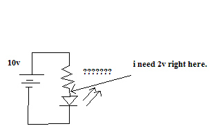

:lol: this is driving me nuts. ive never been able to figure this out:
say that ive got a 10v source. and ive got an LED that has a forward voltage of 2v (so therefore i need to have only 2v going to it). how do i use ohm's law to calculate the value of resistor that i need in order for there to be 2v @ the LED? take a look @ my picture.
i can figure out voltages in a series of resistances but this . . . :evil:
thanx

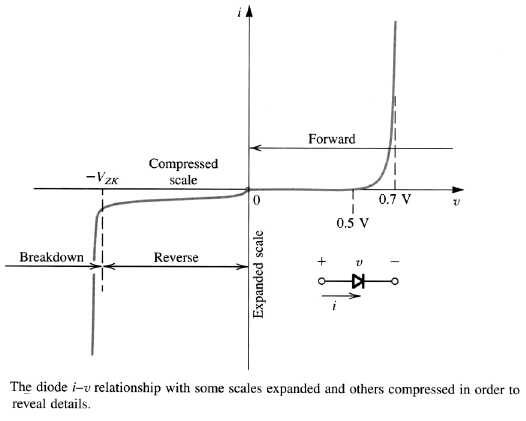

When working with diodes, always work with current constraints rather than voltage constraints. If you look at the I-V characteristics of the diode, when switched on, the current can vary greatly with negligible change in voltage. Since light intensity of the LED is related to the current flowing through it, working with voltages are quite pointless.
Read the specs on the recommended forward current. And choose a suitable resistor that will drop the rest of the voltage given that current.

To be a bit more helpful, you will drop 2V across the LED, as the supply is 10V that leaves 8V across the resistor. So using simple ohms law, you now know the voltage (8V), and you just use that and the current you require to work out the resistor value you need.
But you're not calculating to get 2V - you're calculating for the current you require - the 2V is an intrinsic property of the LED.

Just to do the calculations, 2V drop and 10mA is 800 ohms, if the LED then only drops 1V - the current will be 11mA - BIG DEAL!. As 800 ohms isn't a prefered value anyway, we'd use either 820 (E12 series) or 750 (E24 series) ohms (or 1K? or 680?).
Just grab a resistor with a brown or red stripe at the end and see how bright it is? :lol:
It's hardly a crucial design problem!.

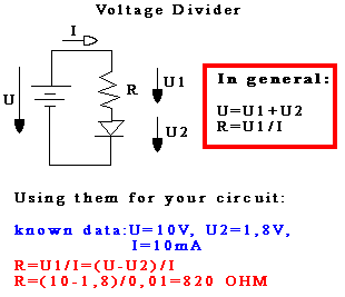

OHM law in practice
U1=1,6...2V and I=2...20mA, depends on the LED.
U1=1,8V and I=10mA are a general values for a LED.

If the manufacturer gives you a nice IV curve like checkmate posted but with the axis labled its easy to find the voltage drop for the LED at whatever current you want. It's always best to give a little margin so you arn't stressing the LED.
