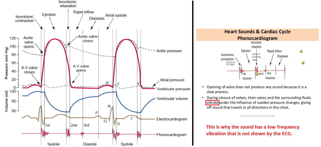

The heartbeat waveforms shown in the Texas Instruments article show pulses of a fluttering low frequency that do not resemble the pulses of heartbeats. Maybe that is why they say, "Warning, do not use this evaluation kit for medical diagnosis".
Look at this explanation that I found:
AG,
Lol I didn't see the warning. It's funny though.
May be they didn't record a heart sound, may be they generated a signal with some noise to test the filters in that frequency range.
