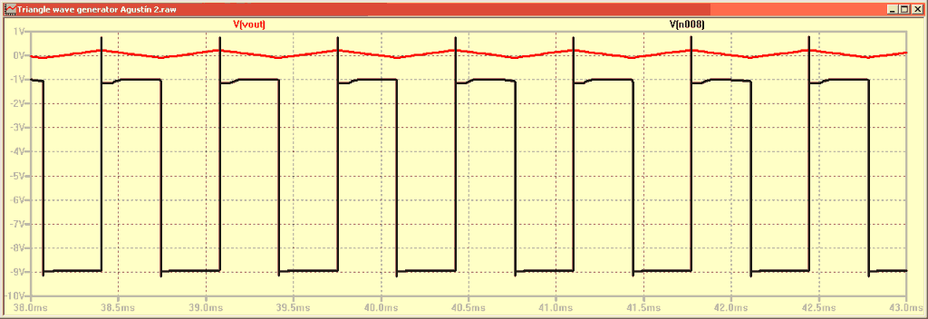

One thing I don't like is how glitchy the square-wave input is to the gate:
But the good news is that adding a load (remember: note to self: always model a load!) quickly stabilizes the output. Plus the current source can easily drive a 5k load (it'll go down to 1K, albeit with some distortion).
I did change R8 to 1K and R5 to 22K to try to isolate the current sink from the oscillator, which helped somewhat. Actually, that spike on the rising edge doesn't seem to make much difference anyhow.

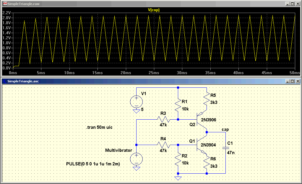

If you wanted to eliminate the current mirrors .....
  • SimpleTriangle.asc
Of course the simple circuit has a very high output impedance so it cannot drive anything except maybe an opamp. Oh, maybe an opamp should have been used to make the entire circuit in the first place.
Yes, it may be a interesting academic exercise to design such a circuit with discrete devices but you can do it with many fewer parts along with better performance using op amps.
I like it very much. For simplicity alone it should probably win the prize in this thread.
So, how does it perform? I modeled it with my multivibrator. It works pretty well.

Notice, however, how the waveform degrades with increasing load (decreasing load impedance). It seems to be able to drive about 20KΩ adequately. If one were to add a couple stages of amplification (a high-Z input CE amp plus an emitter follower, perhaps), one might make a pretty decent function generator out of it. (These are for 20K, 5k and 1K loads resp.)
