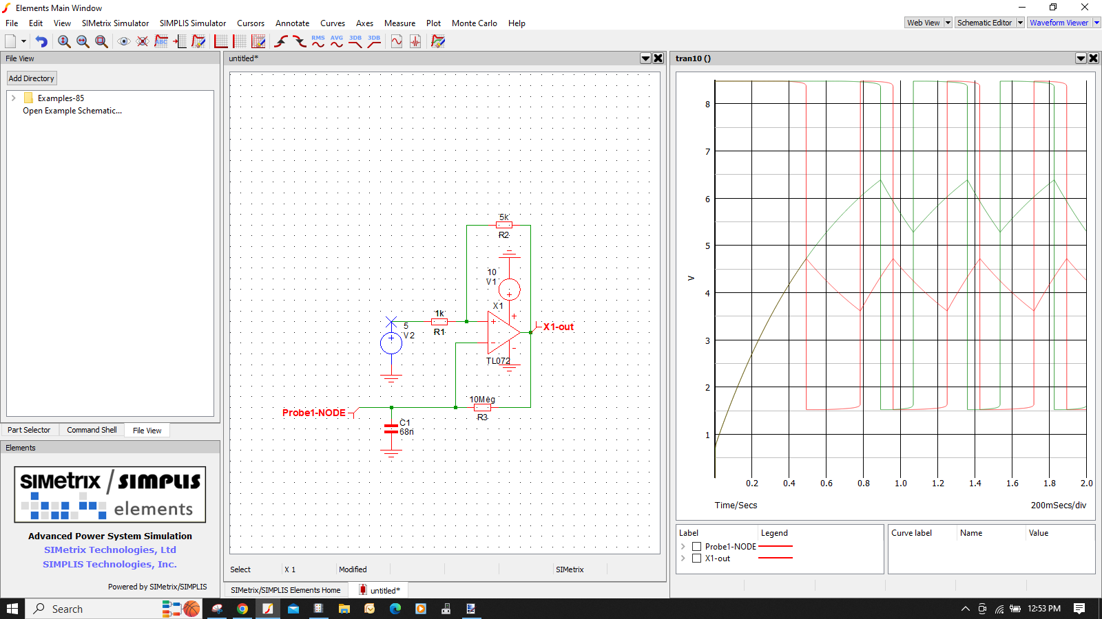

I did a sim with an OpAmp as follows :
I moved one trigger edge 400 mV and got a period change of 170 mS on a rough period of 1 sec,
so if I move the other edge as well I am thinking tolerance >> 20% for sure. Note OpAmp allows
use of small cap, eg leakage << Schmidt. So if we go back to using Schmidt, and its leakage, we have
to use electrolytic and much smaller R, then we have its error to heap on top of this. And I have not
done V supply variation on top of all this.
Could be OP does not care if its once per year or once per uS :) then we dont care.
Regards, Dana.
