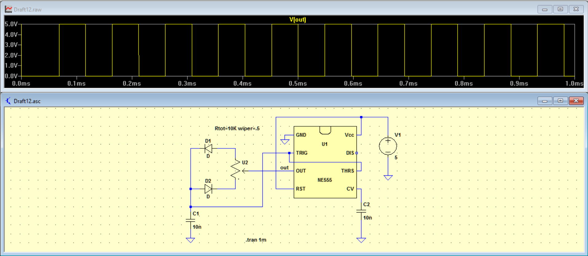

If you use the output pin 3 going through a resistor to drive the timing capacitor that is connected to pins (2,6) and (1) you can get a 50% duty cycle out of a 555 timer with only two extra external components. :cool:

Pin 3, 2 diodes worked.
Nope, not with an ordinary 555 because its output voltage swing is not symmetrical, it does not go up high enough, but the Cmos 555 does when its load is a high resistance.
It's close enough.
If not exact it can easily be compensated for through pin 5.

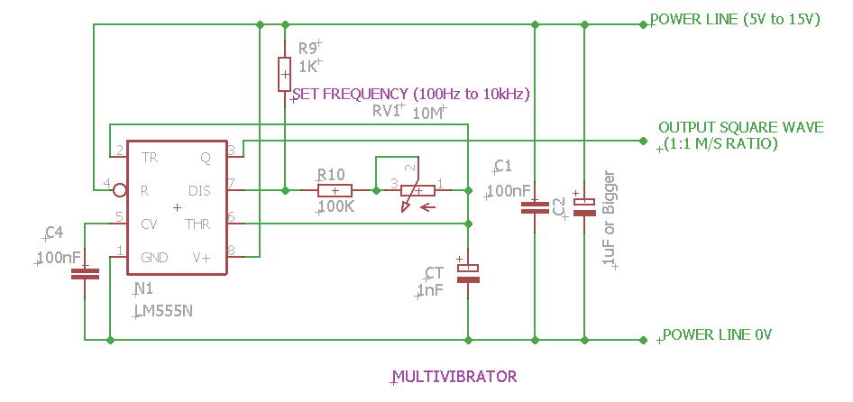

I founf this:
http://www.discovercircuits.com/PDF-FILES/dfliposc2.pdf
I could use one as the oscillator and the other in the same chip as a divider, which also gives me a q and not q and do away with a gdt by winding the primary with centre tap and grounding either end in push pull, dead time mgith be an issue (but maybe not with a jk flip flop) I'd have to breadboard it and see if it works.

That circuit is close, because of the >100:1 ratio of (R10 + RV1) :R9, but it is not considered to be 50% duty cycle. It also suffers from having R9 quite small. According to the datasheet:
NB:Ra in the datasheet = R9 in your schematic.
John

Here's a conventional way of getting an adjustable mark-space ratio, so that 50% can be set simply.
