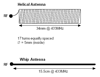

Here's a clip from an RFSolutions datasheet.
I have seen others which give a PCB layout for an aerial.
The behavior of an antenna at that frequency will be profoundly affected by many things including the proximity to other conductors or non-transparent (to RF) materials. Waving your hand past it will affect it. A quarter wave length of wire is a place to start but I think you'll have to experiment - keeping in mind the legal issues already mentioned. I'd argue that others have experimented and found antenna configurations that work well in a given situation or environment. What you'll likely find is that just about anything will radiate - and that your situation won't allow the ideal antenna.
For what it's worth - amateur radio operators have a band at or near that frequency. They do make "rubber duck" antennas for that band - a very short stubby antenna with a BNC, SMA or other connector. They are far from ideal, as antennas go, but are likely to function as well as can be expected given an unpredictable near-field environment. They might offer some directivity or gain but it would seem no more than a well tuned dipole or ground plane. I'd use one of these as a place to start.
