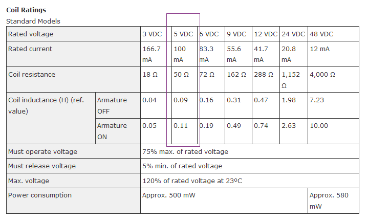

When its all connected together and i messure the voltage over the relay, its only ~1,5V
But when i disconnect the relay, and messure the voltage on Y1, its 5V
My guess is maybe a voltage division will occur because the internal resistance in the 3-8decoder is larger then the internal resistance in the relay, but if this is the problem, how do i solve this?

What is the resistance value of the relay coil.??
EDIT:
it is 50 ohm
hi Yoshidk,
Consider what 'current' the 74HC output pin can supply...... its not going to be 5V/50R = 100mA...
I will not give the answer but you need another device that is a current amplifier between the output and the relay coil,,,, OK.?

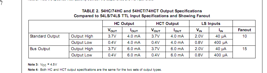

OK.
All you need is a transistor say a 2N2222, connect the base of the transistor to the 74HCT output pin using a series 470R resistor, emitter to 0V and the collector to the relay coil.
The top of the coil to +5V, and IMPORTANT a diode across the relay coil, say a 1N4001.
Look at this clip showing how small the current is from a 74HCT output pin.
