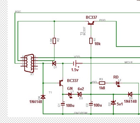

I'm from georgia :) P.S. so the reasin is in lack of voltage on MCLR yes? what if just putting 1.5V battery in series from RS232 V++ to MCLR? Like rs232-Vbattery-MCLR? are the other voltages enough? and when not programming, just 1.5V will be on that pin and it won't make any problems yes?

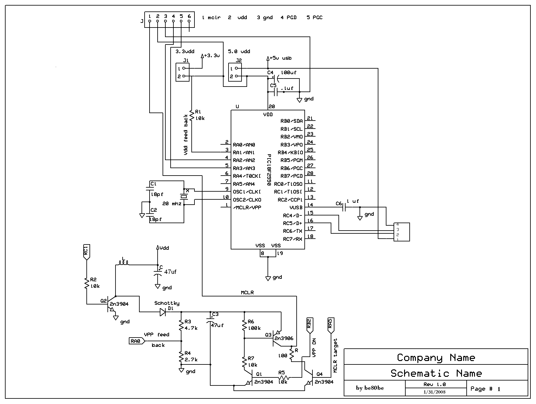

You could try I tested maybe 50 jdm style programmers some work a little better then the rest but if your serial post is low they don't work right You need you a pickit2 or clone of one if you want to make one like this Pm me and I'll tell you how to get a 18f2550 with pickit2 firmware on it for free.

Have you tried your 1.5v battery in series with MCLR
I can't do it because I program with programmer and i don't know where and how to connect battery

You have to like programming to use a jdm and keep at it there a pain. I would say the 1.5 volt boost will do the job

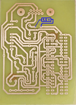

So I have to build a new programmer? can't anything be done with this one?I have absolutely the same:
no no I mean I have the same programmer and there is no way to connect battery. open the pictures and you will guess what I mean
This is the way I would try it.

ok I will try, thanks!
Yes it helped :)) thanks for helping
