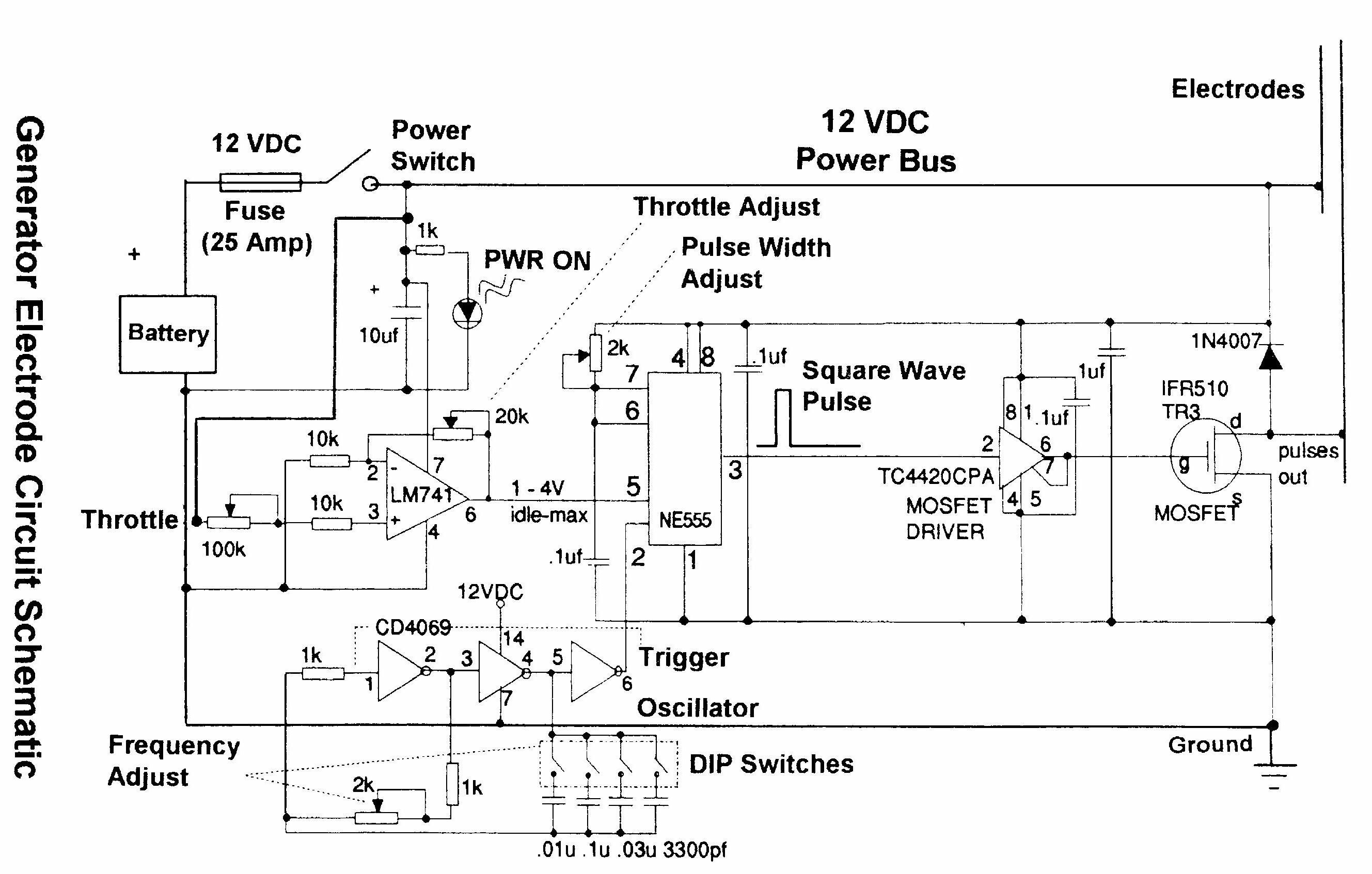

I'm just interested in controlling the frequency and duty cycle using solid-state components, not by using a bunch of pots and switches that could malfunction after a period of use and/or the environment in which it is situated. Looking again at the schematic of a PWM that I have, i know I would have to put it somewhere in the section where the controls for frequency and duty cycle are.
Edit:
I have found a PWM that uses Dip Switches to control the frequency and uses a pot to control the duty cycle. That would simplify my search for a method to self regulate the PWM. I have attached the PWM drawing that I found.

I looked at that chip and its interesting that a PWM can be achieved using that IC. How would one adjust the output of the PWM using the HV9910 IC?
