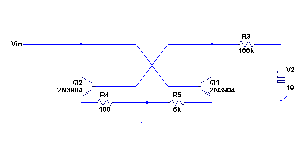

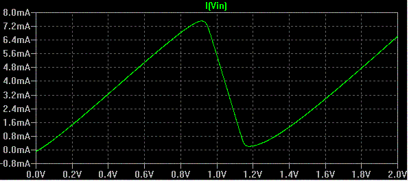

Resistance, in the most general sense, is change in voltage divided by change in current, expressed mathematically as dv/di. In any circuit where DC current flows, this can be measured.
I cobbled together a simulation, and am posting the schematic and resulting voltage vs current curve below. In the graph, Vin of the schematic was swept from zero to two volts, and the current from Vin is plotted on the vertical axis. The regions with positive slope (0 to 0.9v and above 1.2v) have positive resistance. The region in between has negative resistance. The dynamic resistance at any point is the slope of the curve (dv/di) at that point.
For comparison, if we had plotted the curve of a 1kohm resistor, we would see a straight line from the origin (0 volts, 0 current) to the point (2v, 2ma).

The derative of voltage with respect to current dV/dI is (as RonH said) the dynamic resistance, sometimes called the slope resistance. Devices such as Tunnel diodes, Unijunction transistors, SCRs etc. all have regions of negative dynamic resistance.
With a normal resistor its "static" and dynamic restances are equal because if you differentiate V = R I then dV/dI = R.

I doubt that. I conjured this circuit up just to illustrate the concept of negative resistance. I can't imagine how it would be used for reverse polaity protection. You might have seen something similar. Can you post a schematic?
